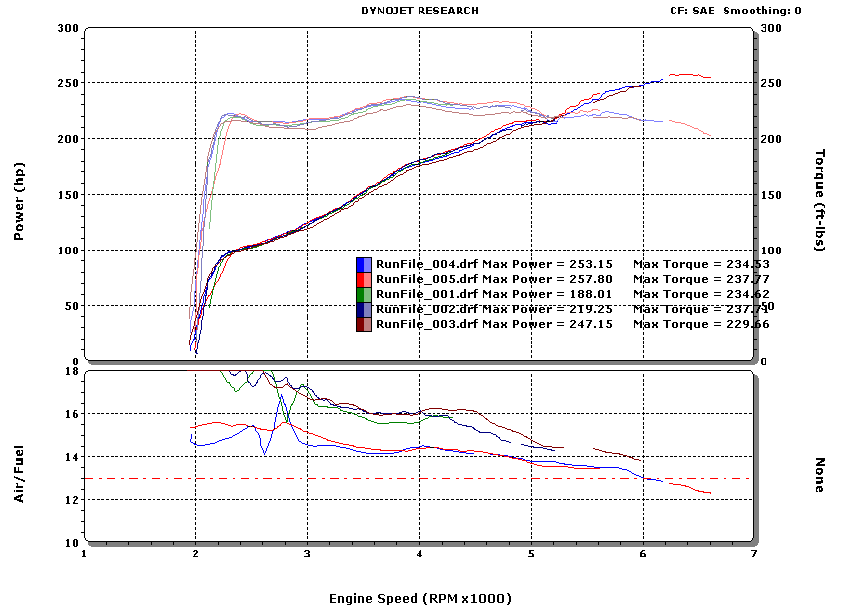

Old Jan 8, 2005 | 10:03 AM
sentry65's Avatar
sentry65
the burninator
Posts: 9,722
From: phoenix, AZ
here's my dyno
really dissappointed with these numbers
these are my original 3 dynos with horrible A/F
and 2 new dynos after TS adjusted my A/F - still not that great, but at least my engine wasn't detonating this time...
I'm just going to get the greddy emanage - obviously this is going to take forever having TS try to blindly adjust things
My check engine light came on again this morning - probably the same misfiring code as always - maybe I should go back to stock ECU or get a whole different one or something...
I should have a lot more power than 257rwhp with my mods
