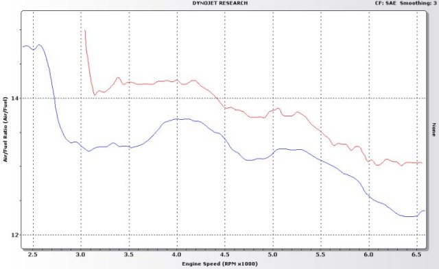

Well, when I did a base dyno I was about 232 hp and my A/F was right around 12.5ish. When I recently did my "after mods" dyno (with everything in my sig) I was only at 239 hp and my A/F was in the 14's! Everyone said that I was WAY lean and that if I got it back down to the 12.5 to 13 range, I would make up the missing hp (plus not detonate my engine).
Originally posted by myz8a4re
in what ways is your a/f dangerous? are you running that much leaner? the MAF should read the extra air & add the needed fuel to keep you in a safe zone. i realize a slightly leaner a/f can be had but it shouldnt be that bad! please advise, i dont want any ill effects from my mods.........
Well, I think that the ECUcan adjust the A/F somewhat, but when you start putting on a lot of mods, it can't adjust enough. That is why people get their ECU's flashed, or go with a Piggy-back unit.
Here is a picture of my A/F ratios both stock (Blue) and after mods (Red). As you can see, it has the same basic shape, but is on average .6 higher now than before and mostly in the 14's.
