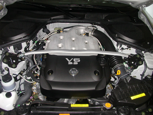

All finished...about 1.5 hours for a nice and neat install...
Attached Thumbnails Sun Auto's Hyper Ground / Earthing System-350zengine.jpg
