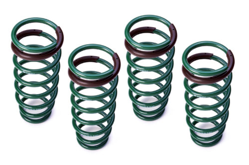

Here is some new stuff from TEIN.
The S. Tech has been developed with high quality materials guaranteed to be sag free (of no more than 5mm) and comes with a protected rubber tube for noise and rust prevention.
--Made in Japan.
--Adopted high quality materials (SAE9254V) to be lightweight and to maintain maximum stroke.
--All products have been tested on each individual vehicle application for exclusivity design.
--Gives about 1.5 inch drop for a more aggressive appearance.
