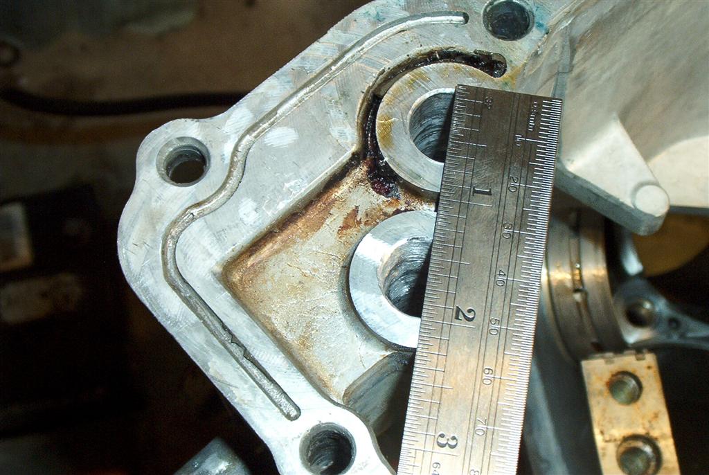

What it appear to me is that we don't want or need that 90 psi to run our valve train controls and the rest of motor doesn't need it either.
The size of the bypass hole of the pressure regulator on the oil pump is .350" this may not be large enough for the pump volume versus bleed off rate.
Or the regulator is set very high from the factory hence the use of O-ring seals on the pressure side the system.
All main oil passages are now .625" min. and are smoothed at the intersections.
Attached Thumbnails RPM vs. Oil Pressure questions/ Oiling Mods?-im001255-large-.jpg   RPM vs. Oil Pressure questions/ Oiling Mods?-im001254-large-.jpg
