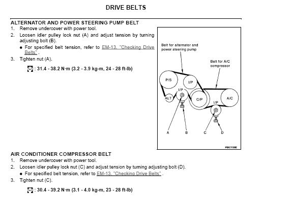

This is the section of the Service Manual I'm working from.

Yep same page I told him to look at. Good stuff posting it for people who dont have it.
putting the car on stands, removing the under tray and get at it from the bottom. You realy dont need to use a torque wrench to tension the bolt, you need a tensioner guage to show how much deflection you have under a specific load on the belt. Or the southern way of doing it, push on the AC belts and give it the same feal as that one.
To get at it from the bottom you'll need some extensions and a swivel socket adapter.
I like the Auto tensioners on the 200sx's GA16DE's. They have a massive spring load that pushes on the pulley. To remove belts you put a breaker bar in the square 1/2 hole and pull back. To tension you just let it go.

Ok...I just figured out its actually the a/c ompression belt thats squealin like a pig, not the alternator/power steering belt. but now, i'm all lost in regards to how tight things should be since I dont have a tensioner gauge, and cant do it the "southern way" mentioned by punish_her because i've been playing with the tensions the whole time...help?!?

Each belt has it's own tensioner pulley, so just tighten each one a bit. I've also heard of the alternator pulley itself making a constant squealing sound (not belt related) on some VQ cars.

Ok...well i just tightened both pullies. The main squealing went away. There is a slight hiss, but I'm not sure if I'm listening too hard or just paranoid since I "guesstimated" everything since I don't have a tensioner gauge. Thanks for the help everyone and definitely couldn't done this without the service manual (good call punish_her!
