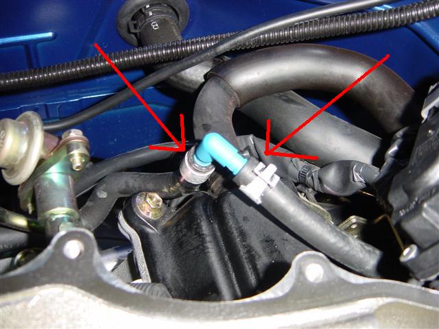

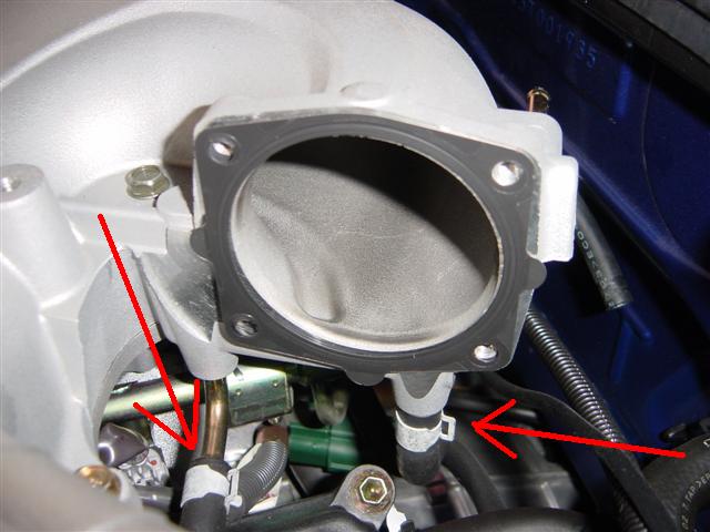

Default water bypass
this "mod" is used to re-route engine coolant in the 180-210 degree range away from your intake air.
my last 3 cars have all had this, and i have bypassed all of them without incident. all you do is basically remove the feed and return water lines from under the intake manifold cover behind the throttle body. i used a 1/4" 90 deg elbow from my watercooling parts for my PC. you could use anything appropriately sized.
the original reason for car makers to do this is to make the TB not freeze... so, dont do this if you live where it freezes (or atleast hook it back up in the autumn!! )
here is the before pic:

after:

Skidaze: Would you mind going into more detail about this bypass mod? The pics look great. My friend with a Z06 did the same mod and said he noticed a major difference.
How long did it take? Is it a mod where you can tell the difference? If so, is it a difference you can feel like a CAI install or maybe like a grounding kit?
Thanks in advance. You are an asset to the Z33 world.

Skidazzle,
Well done. I admire your taste...the polished manifold looks truly sick against the DB paint. As for your bypass mod, I see how you used the 90 degree fitting to tie the two lines together away from the throttle body. My question is that after doing so, does this leave two holes in the throttle body where the lines used to go? If so, what did you use to plug them? Thanks in advance...great idea for us southern Z owners!
