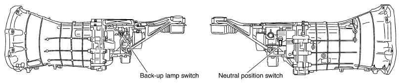

I'm in the middle of installing compustar and I can't find the clutch wire or the neutral position wire at all. Can someone please help me asap? Thanks!

Attached Thumbnails Help - looking for clutch and neutral position wire-snap.jpg

The clutch wire should be on the clutch.
The NSS wire will be at the ECU, under the passengers dashboard.
It would have helped if you would have told us what year your car is. If it's an '03 the NSS wire is Brown/Yellow. I don't have info for any other years.
