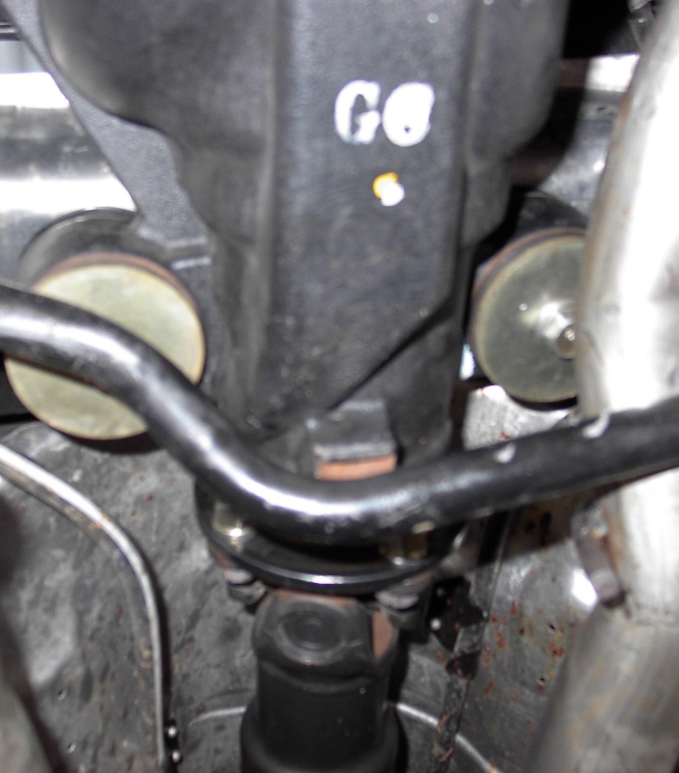

I just finished reinstalling everything. I started it up, still on the jackstands, turned off VDC, and put it in drive. Everything seems to be in order. Neither the driveshaft nor the axles seem to be out of balance or wobbling any, no unusual noises anywhere, no leaks.
I'm about to take her for a spin!

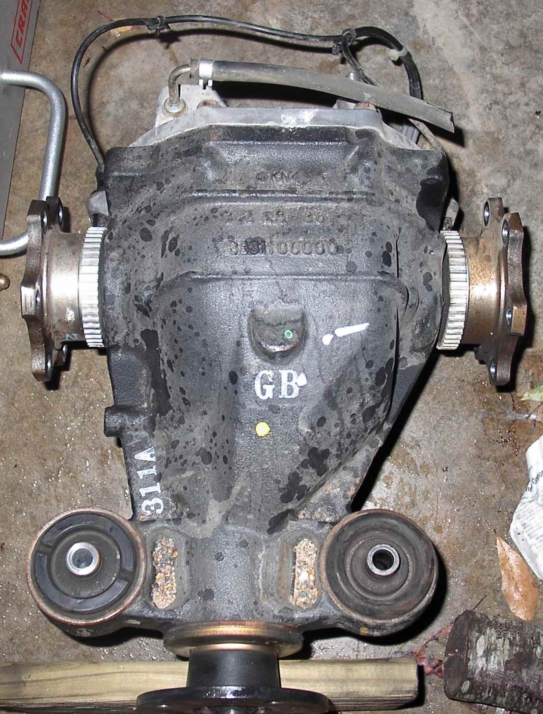

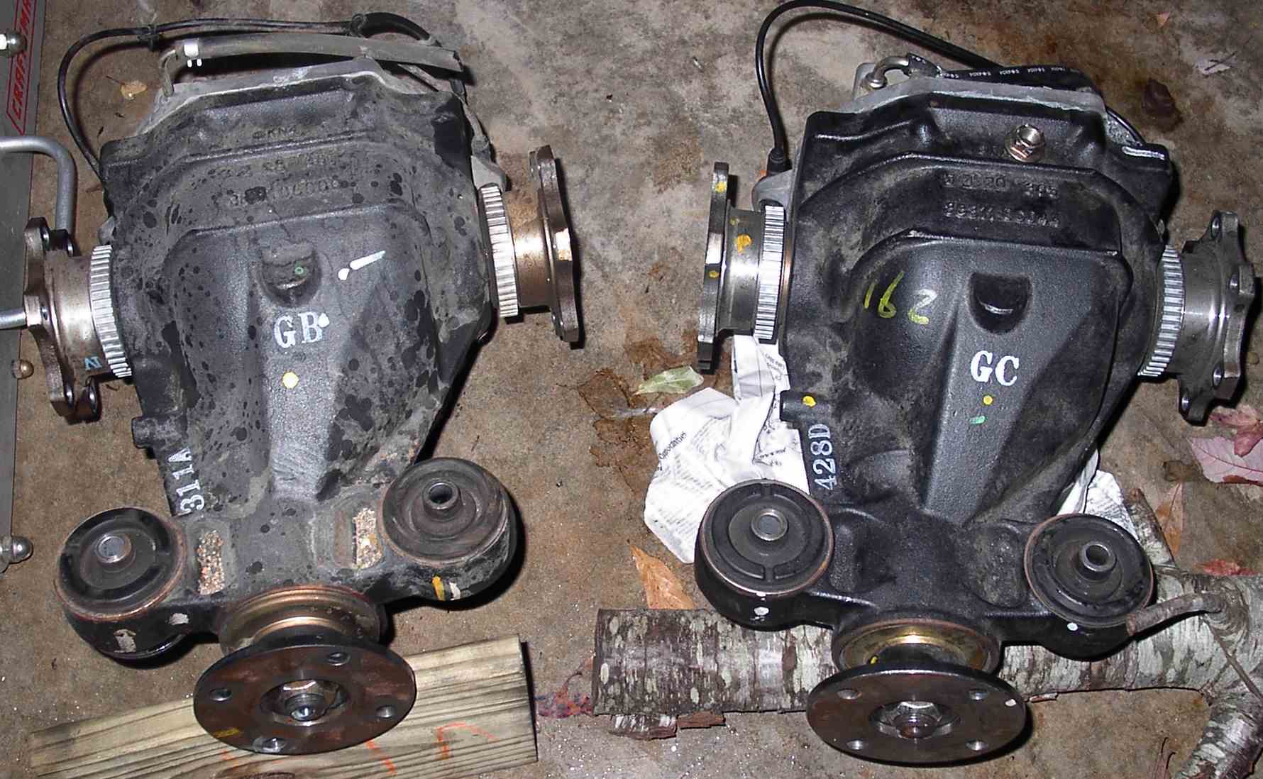

pics...
You can see in the side-by-side the difference in the housings and in the way the bearing/seals are. The old one (left side) has the "cover" (shiny brass-colored donut) the same diameter as the outer-most portion of the pumpkin housing. The newer diff housing actually encircles the "cover", therefore the pinion opening of the housing is a slightly larger diameter and sticks out toward the front of the vehicle about 8-10mm more than the old diff. However, measuring from the front of the companion flange to any common reference point on the two pumpkins will yield the same measurement. I've taken several pics measuring between various points using my tape measure
, and all the measurements are the same.
Now, on to the more important issue. How well does this mod work???
Overall, I'm pleased. There is no real noticeable difference in low speed acceleration, and I expected this. However, the faster I travel, the quicker my car accerlerates relative to what it used to at the same given speed. My cruising rpms at 75 mph are up by approximately 300 rpms (if my memory serves). My car does go through the revs a bit quicker, especially once I get into upper 2nd gear and all the following gears. I can spin the tires from a stop now, which I was unable to do before, even with vdc off.
One thing that urked me was that my cruise would not work for awhile. I would turn it on, the cruise light would illuminate, but the set light would continuosly flash. After about 30 minutes, it decided to work. I use my cruise almost religiously since most of my commute to/from work is highway. Hopefully everything will continue to function properly.
BTW, please pay no attention to the German Shephard entrails splattered about the bottom of my car (trust me, the rest of the undercarriage is much worse).
, and all the measurements are the same.Now, on to the more important issue. How well does this mod work???
