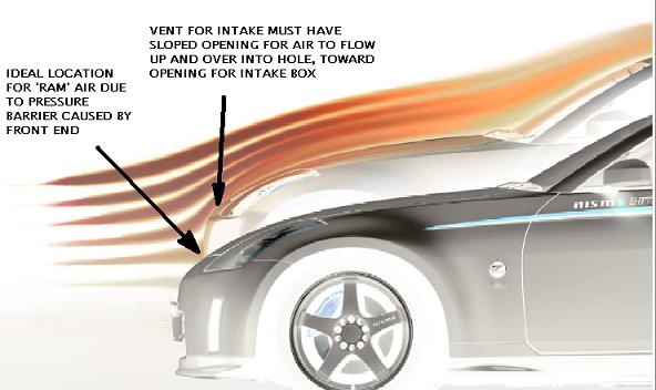

another idea:
use the car's exisiting aerodynamic design and put an air channel from the high pressure zone where the nose creates infront of the car, and port that air into the stock air box. you'll be getting a free ram air affect as well.
this section of the car is clearly noted from those ADVAN/GT-class Z pictures where there is that smaller rectangular box in the front of the bumper.
this can also be shown with the wind tunnel images of the Z from NISMO japan's website.. there the smoke splits up and down is a stagnation point of high pressure... open that up and you got free energy.
you can also cut a hole in the front bumper and insert a gradually sloped channel into the stock air box.. but that opening vent must be a gradual slope and not just a straight piece, due to the fact that air has to flow smoothly over the opening and into the hole.

I dont think it will work as you expect. any differences would be more like .001 rather than .1
your grill mesh is not likely to cause any problems with intake, cause plenty of air can still pass through, and your not getting any "ram air" as it is, so the speed and volume isnt really important. for ram air, you would need to do basicly what was above, hit it right through the bumper... anything else you just want it to draw air from a colder area, which the front will provide regaurdless of what covers it.

Just a minor observation, but the Injen is setup so that the air inlet is perpendicular to the air flow. You might want to see if you can get the air inlet to be parallel to air flow. I'm not sure how the Injen air filter is configured ( open-top design or closed?). But if the air inlet is parallel to air flow, a dome shaped filter (GREDDY, RACTIVE, HKS,etc...) or one with an open top (RSA, RACTIVE, JWT,K&N XSTREAM) would be more promising, IMHO.
Just ideas.
Just ideas.
