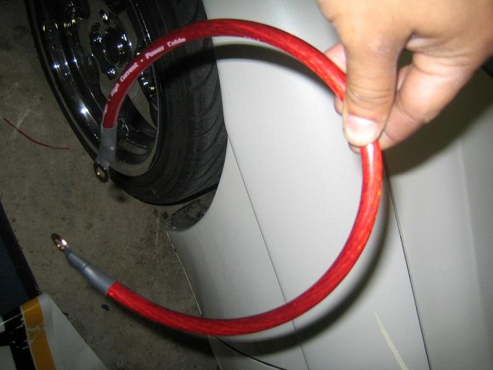

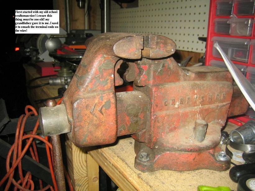

So i decided to follow the tutorial on that other web site! - 350ztech.com and i made my own grounding kit!
i thought i would share it with you guys! i plan on installing it tonight so ill have pictures of it in the car hopefully tomorrow.
I used 4 gauge wire and 1/2 inch heat shrink! an old school vise and my trusty heat gun and here ya go!
- Jason!

Default my lab!
pic of where it all went down!

Default All Finished!
Okay: heads up! the 350ztech.com tutorial for this says to use 4 each M6x20mm length bolts! but i found that those are too long! I had to use 3 each M6X16 mm lenght bolts from a nissan bolt kit from autozone i had. (about 5 bucks at any autoparts store)
- J
Attached Thumbnails My own Engine Grounding Kit!-img_1947.jpeg   My own Engine Grounding Kit!-img_1946.jpeg   My own Engine Grounding Kit!-img_1944.jpeg

well, its late so i just started the engine and it was a nice clean start, ive been noticing my weaker starts lately and im pretty sure im due for a new battery soon. I started it up and chedked around with a flash light to make sure things were all buttoned up! but i havent had the chance to drive her yet to notice anything.
read the 350ztech.com tutorial. click on tech on the right side then click on grounding link. its pretty informative.
