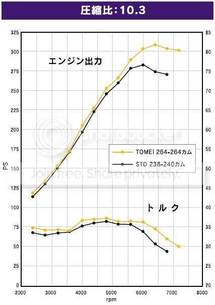

Would I really limiting myself by revving to only 7.2-7.3k? Do the 264's make decent power past 7k? Thanks for answering my questions.

becomes a function of the quality of your porting job, the quality of your plentum design and your header design..and then of course, the tune
