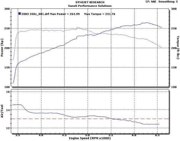

Thanks for those that are offering encouragement. I post some pics of a real build that is taking months to complete and I get hated on. That is why alot of people don't really want to share any information that they discover doing projects like these. Its unfortunate because there is information that could help others that want to do a NA build.
Resolute, the VTC angles I posted were for the NISMO 276 duration intake cams. It came off a chart on the NISMO website. I am assuming those angles will be a good ball park to start with for my cams since my cams are 272's.
OK...here is my before dyno....if I can't gain 37 rwhp with the Cosworth intake and a tune I am going to be very disappointed. LOL Just playing...if I don't oh well...I least I learned a few things.

I am debating getting the FCON just for the timing and fuel and getting a flash to adjust the intake cam angles and idle. If not I will get a motec or I only need to adjust the VTC angle after 4000 rpm to redline. I didn't know about UpRev...I live close to them for so that might be another way to go.
Again...as far as bigger cams...I didn't want to be a the beta tester. The people I spoke to wanted me to give them all the cam data for both intake and exhaust cams. What the heck do I know about that?
