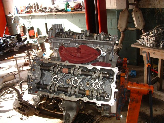

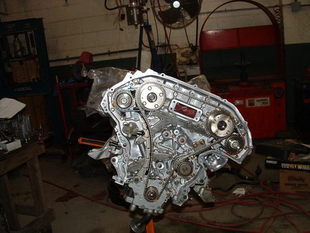

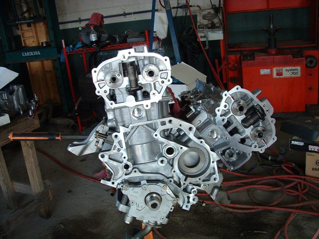

Went by the shop again this afternoon to see the status of my motor. They got the motor assembled and piston to valve clearances checked good. My builder just need to install the oil pan, manifolds, and accessories and then back in goes the motor. I was hoping to try to start the motor tomorrow but my builder said he fell behind and its looking like early next week. Here are some pics from today.

What RPM limit will you set for it?
It depends if I can continue to make power past 6600 rpm with my current intake manifold. If these cams make power to 7700 rpm I will run it to about 8000 rpm. If I can't make power past 6600 rpm I will set it for 6900 rpm. I am looking for reliability since I will be tracking the car in NASA and PCA events.

Are u doing any work to the bottom end? What rods are u using? Also any boring of the block? Stock crank or what?
I did not have the motor processed, balanced and blueprinted. I didn't process the block because local shops don't really have a reliable record. Using eagle rods, standard 95.5 wiseco pistons (11 cr but ended up with actual cr of 10.7) and stock crank. I actually should have waited for another month and I would have just purchased the Cosworth shortblock. Oh well.
