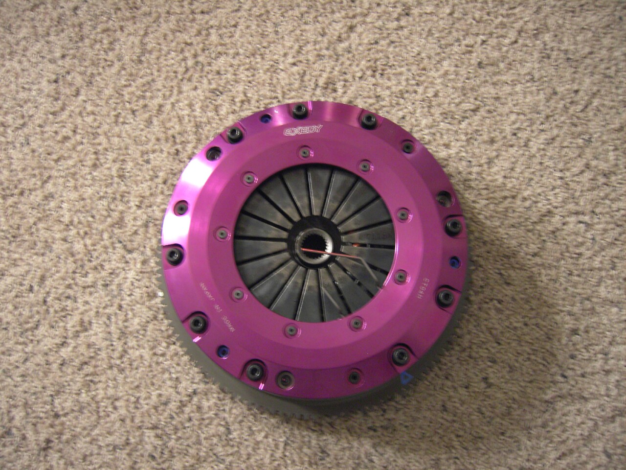

Ok, first of all, this thread has all the basic information on the clutch, including my preliminary review, quoted here:
Well, I just had this clutch installed on my G, and I'm waiting for an upcoming track day to give a full review, but for a very short review, I can say the following:
Pedal effort is about 110% of stock pedal effort. In other words, just slightly more.
Noise is same as stock. No idle chatter, no extra noise, no nothin'
The engagement zone (area where you can slip the clutch without it being fully engaged) is about half of what the stock clutch is. It's not an on/off switch like some high performance clutches, but there is not as much give in it, compared to stock, either.
Clamping force is awesome! My stock clutch was slipping with the JWT TT kit, but this will grab hard! I haven't dumped the clutch from 5k rpms yet, since I am still breaking it in, but I bet it will grab that hard. No slippage at full throttle in any gear.
All in all, it's a great clutch; when I get a full review together, after the March 9th track day, I will link to it here.
So, after the track day, I honestly don't have anything much to add.
The clutch withstood all the abuse I threw at it, including downshifts at 125 mph at the end of the front straight, and max torque/hp runs up the front straight. I was using it very heavily all day, and it never complained, not even once. For reference, I have 355 ft-lbs at the wheels and 363 rwhp in my JWT TT G, so the clutch was taking a beating. It felt like stock all day, with no problems whatsoever.
If you can afford it (because it is a pricey clutch), and you are going forced induction, I highly recommend this clutch.
Attached are a couple of pictures, pre installation.
Dave

Dude, it's PINK, thats a little girly

It's actually purple, but who cares?
