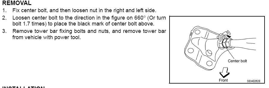

Did you loosen the two nuts to either side of the center bolt?

u have to loosen the tensioner bolt... but b4 u do mark ware it is with a sharpi
