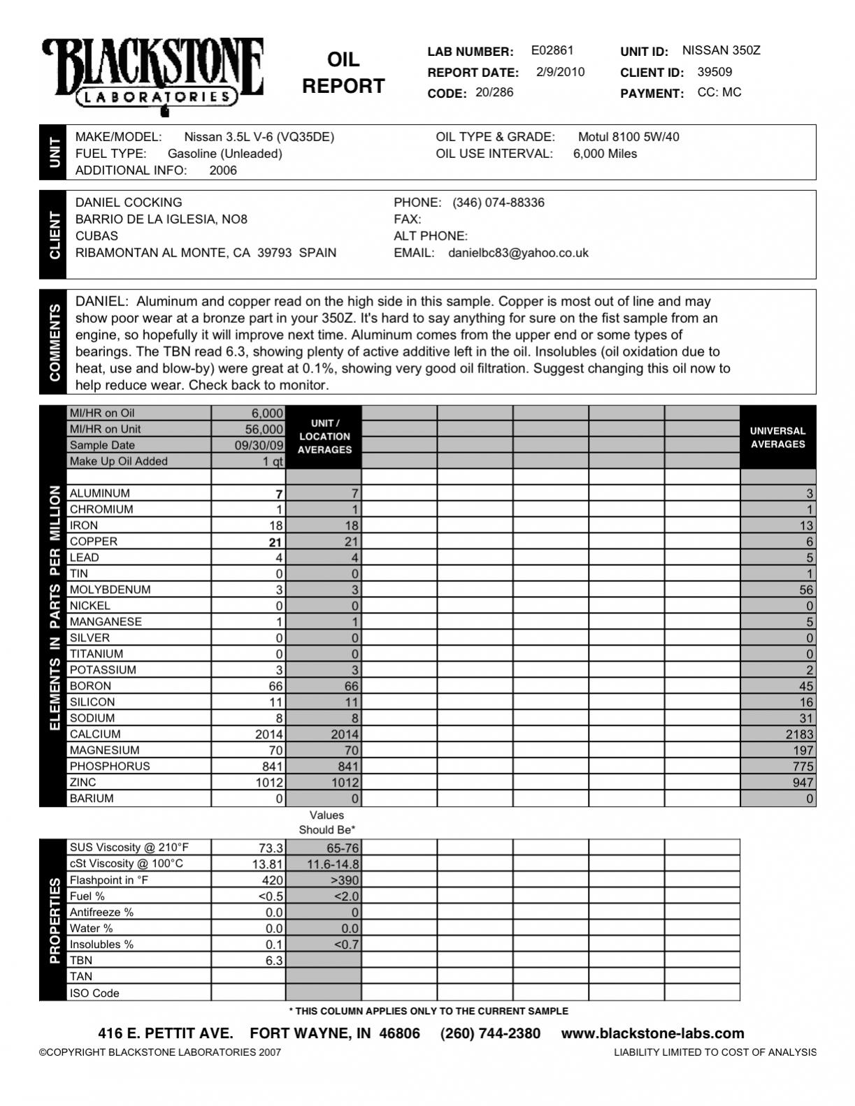

Default Motul 8100 5W-40
Got my sample back from Blackstone today. The aluminium and copper contents are a little worrying.
It has 3 track days on it.
I'm also running an oil cooler.

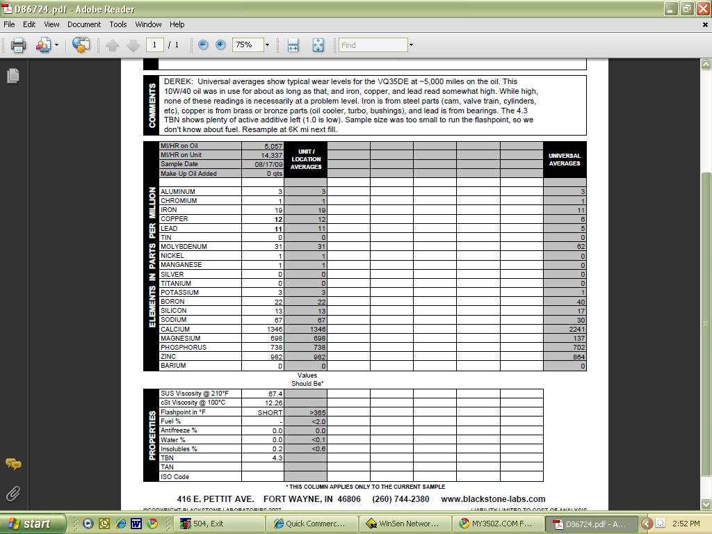

Stealership told me the oil was Castrol GTX synthetic. Went with Mobil 1 synthetic and will be doing another analysis to compare.

Yeah, your Cu and Al are a bit off, and it suggests bearing wear. I have yet to see a UOA of Motul in the VQ that suggests it's worth what it costs, but that's not to say this UOA gives reason for concern. It's on the high side of wear, but nothing to really worry about. What this UOA really shows is that while nothing indicates that a change in oil brand is required, a change might get you even better results with less cost. Since you have access to a number of nice oils which we don't have here in the US, I would give Shell Helix Ultra 5W-40 a try, or Castrol Edge 0W-30. Fuchs also has some excellent oils, especially in their Silkolene line-up.
