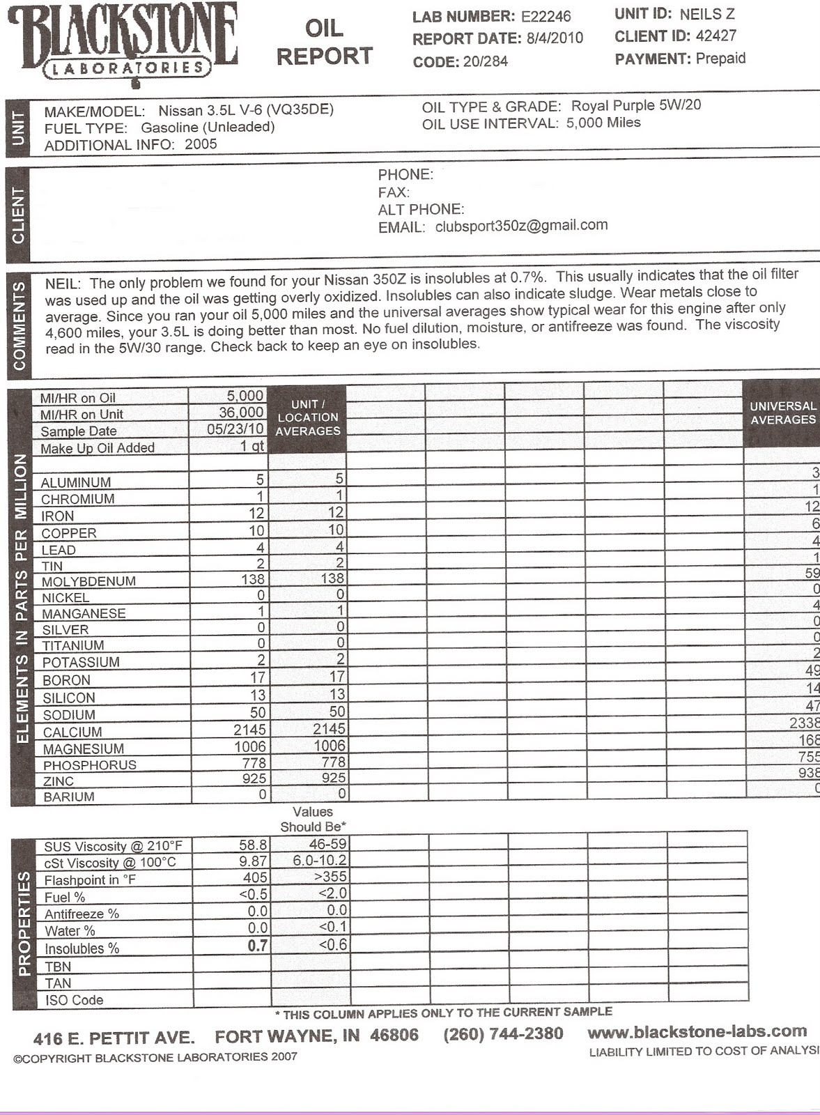

Here's mine after running Royal Purple for 5000 miles. Can anyone direct me on how to rectify the insoluble’s issue? My goal is to move to a better filter; Mobil 1 and switch to Pennzoil Ultra. Would Sea Foam in the crank case assist in cleaning up any sludge?
What filter did you use for this run, and was the oil really 5W-20?
I doubt there's sludge in 36K miles unless there's been some history of neglect with regular oil changes.

No it was a typo it was 5W-30 and filter appeared to be OEM but longer than stock. My independent Z shop did the oil change, their big fans of RP??, but I’m doing my own oil changes now, hence the move to the Mobil 1 filter and Pennzoil Ultra. I purchased the car in January and it appears to be well maintained but the oil report indicated the possibility of sludge so I’d like to address that with the next oil change this Saturday.
