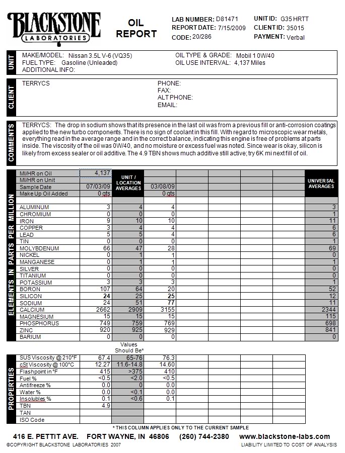

Originally Posted by Resolute
The M1 sample looks very good. Like Nederlander75 posted, most M1 0W-40 samples are shear stable as a heavy 30 weight oil, and therefore show up in a UOA as a high 12.xx cSt viscosity. My own sample with 3200 miles (albeit with 410 track miles) being a typical example. The P amount is low for M1 0W-40 as well. What is really weird, however; is how your M1 0W-40 has very little boron in it. While the other M1 0W-40 samples all show a healthy dose of borate esters, your sample is lacking. Same for Molybdenum, where your sample shows about a third of the average amount of moly used in the M1 0W-40 formula. The calcium level is also well outside of the standard deviation for the average amount contained in M1 0W-40. Either this is some new formula of M1 0W-40, or it is not M1 0W-40.
As far as wear is concerned, the values all look very good for a TT engine with 4k miles of use.
The high Si and Sodium are a concern. Neither are used as part of the additive package in M1 0W-40, so this is not normal levels for this oil. First, and most obvious, is double check the air filters and vacuum hoses for any leaks to allow these elements to be ingested into the crankcase. There are a number of other ways these elements could become elevated in an oil sample, but check the obvious solutions first and get another UOA during your next change to check trending.
Will
Interesting ... it looks like the boron, moly and calcium levels took a big turn around. I know for sure I have M1 0W-40 in it this time because I put it in myself. Now I wonder what the shop put in after they installed the TT. What are your thoughts regarding the huge boron swing?
The sodium came back down significantly but the Si is still the same. Would excess sealer cause this as the lab report says? If not, I may have to look around a little more to see where dirt is getting in.

Yeah, THAT is M1 0W-40. The boron is primarily from borate esters used in the formula. All the specs are in line with M1 0W-40, and now you have a good comparison to evaluate what I said about your first sample looking a little "off" for being M1 0W-40. The viscosity is thin for a 40 weight, which is normal for this oil. It looms like a good run with low wear, normal viscosity, nothing out of the ordinary and nothing to worry about aside from the silicon. How many total miles on this engine?
Will
edit: this is a stock block engine with a TT kit, correct? How many miles total since the install?
Will
Yes, stock block HR with TT.
28138 total miles on car
10762 boosted miles
Are you thinking the excess Si could still be due to the sealants used when the TT was installed?

No, I think if it were from the RTV and other sealers used, the ppm of Si would have tapered off after your first oil change. However, it seems odd that if it were dirt ingestion from poor filtration or a vacuum leak that other minerals (such as Al) wouldn't be higher. AFAIK, M1 0W-40 doesn't silicon as an additive, either. I would recommend you check for any leaks were dirt may be ingested into the engine, such as your air filter condition or vacuum ports.

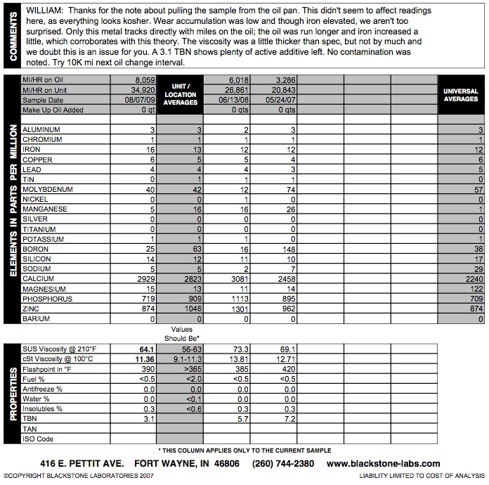

My latest UOA. More than one year on the oil, and more than 8k miles. UOA looks great. Low wear and no issues. The air and oil filters did a great job over the long haul. Oil thickened up, most likely oxidative. Interestingly enough, this is a trend in Pennzoil Platinum 5W-30. Of the six samples I have, the longer the mileage on the oil the higher the viscosity, peaking out at 11.3 cSt with this sample at 8k miles. I would normally be a little concerned, but knowing about the additive package in PP alleviates any worry that varnish or sludge might be an issue. Frankly, I'm very impressed with this oil. I would drive the car for short trips less than 15 minutes to work, and then let it sit for two or three weeks at a time, and then take her out on a weekend and drive the **** out of her. I mean, I have less than 15k miles on my Kumho ASX tires and they need to be changed now from outside front camber wear on the fronts and just beat to hell out back from hard driving and track days. Also, over the course of 8k miles and almost a year and a half, I lost about 7/8 of a quart. I checked the dipstick just before draining it, and it was just a little above the "L" mark. That's perfectly reasonable in my book.

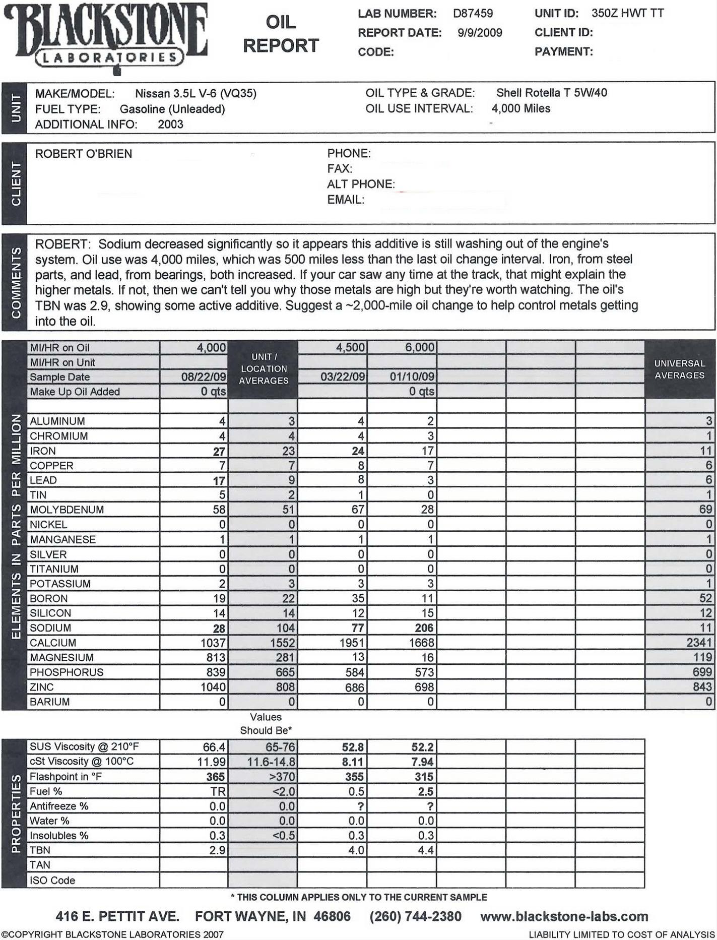

Arrow Rotella T 5W/40 on Stock Block VQ35DE w/ JWT 700BB TT
I'll post a copy of the full print out this weekend. Ran Rotella T 5W/40 for 4000 miles on my Z. One full track (HPDE) event and 2-3 1/4 mile events. Normal Robert_K aggressive street driving otherwise.
Originally Posted by BlackStone Labs
Sodium decreased significantly so it appears this additive is still washing out of the engine's system. Oil use was 4,000 miles, which was 500 miles less than the last oil change interval. Iron, from steel parts, and lead, from bearings, both increased. If your car saw any time at the track, that might explain the higher metals. If not, then we can't tell you why those metals are high but they're worth watching. The oil's TBN was 2.9, showing some active additive. Suggest a ~2,000-mile oil change to help control metals getting into the oil.
Elements in PPM
Aluminum: 4
Chromium: 4
Iron: 27
Copper: 7
Lead: 17
Tin: 5
Molybdenum: 58
Nickel: 0
Manganese: 1
Silver: 0
Titanium: 0
Potassium: 2
Boron: 19
Silicon: 14
Sodium: 28
Calcium: 1037
Magnesium: 813
Phosphorus: 839
Zinc: 1040
Barium: 0
Properties
SUS Viscosity @ 210*F: 66.4
cSt Viscosity @ 100*C: 11.99
Flashpoint in *F: 365
Fuel %: TR
Antifreeze %: 0.0
Water %: 0.0
Insolubles%: 0.3
TBN: 2.9
Old Sep 11, 2009 | 09:46 PM
  #874
Resolute's Avatar
Resolute
Posts: 2,097
From: @7000 ft
Robert, I predict a built engine in your future.
Fact is you've got a fuel dilution issue. The report shows trace amounts, and that's after you driving it and burning it off. It shouldn't be trace amounts, it should be "0". The fuel will cause bearing wear and lower your flash point. In addition, your sodium level is high. BL is saying no coolant, but the sodium is coming from somewhere. Is your coolant low? If not, then it might be from some gasoline additives which contain sodium.
I think your stock block isn't going to wear so well for you as most others, no matter what oil you use. I'm not predicting catastrophic failure, but it's not the cherry that QuadCam's boosted stock block is by comparison. T-Syn is good stuff, and has done well by a lot of boosted VQ's. Maybe try M1 5W-40 (branded as turbodiesel oil, it's also SL certified for gasoline engines) and see if it helps any with controlling excess fuel from blow-by.
How are you guys, btw? Texas still treating you alright? Family is doing well up here, and we're looking forward to a nice and icy winter.
Will
edit: have you had the engine compression tested lately?
Old Sep 11, 2009 | 11:43 PM
  #875
Robert_K's Avatar
Robert_K
Didn't Go Cheap
Posts: 12,390
Likes: 101
From: Spring, TX
Will
A build has been foreseen for a couple months now. It's the $$$ and me going to school that has push it back. I have nine weeks left and hopefully land a good job or headed back to Kuwait. I've never did a compression test on the Z. I'll look into it. THANKS!
Ada & I are doing pretty good. Again just waiting for me to graduate and see what's the next for us. Texas is good but it's always been home for me. No icy winters for us I'm sure. LOL Glad to hear Becky, family & yourself are doing good.
Thanks again for breaking these down for me. I'll get the full print out posted soon.

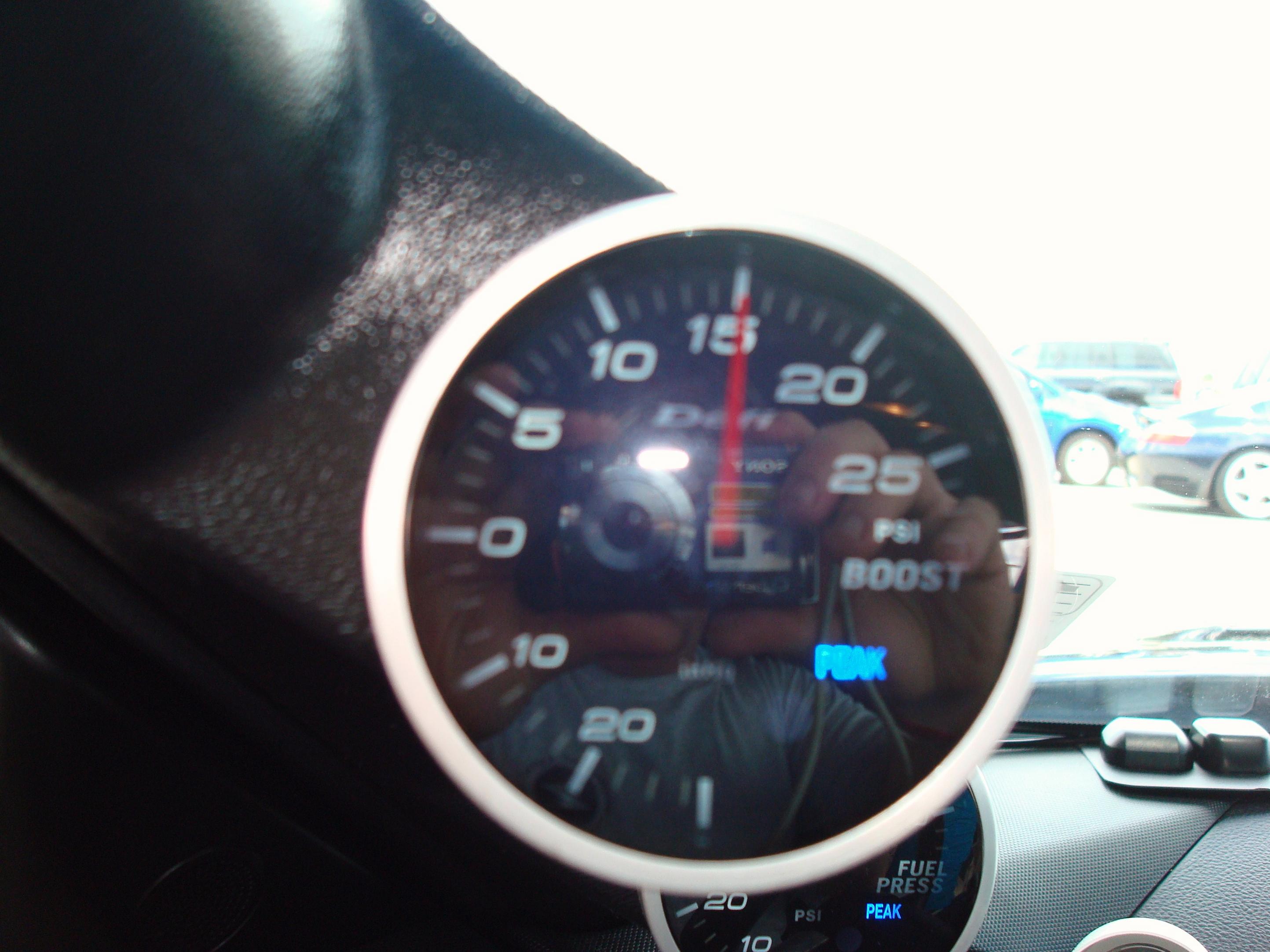

Sorry I didn't get the report print-out up sooner. Should be attached! Also... The boost gauge shows what happens when you bust the wastegate line. Stock Block.
Elements in PPM
Aluminum: 4
Chromium: 4
Iron: 27
Copper: 7
Lead: 17
Tin: 5
Molybdenum: 58
Nickel: 0
Manganese: 1
Silver: 0
Titanium: 0
Potassium: 2
Boron: 19
Silicon: 14
Sodium: 28
Calcium: 1037
Magnesium: 813
Phosphorus: 839
Zinc: 1040
Barium: 0
Properties
Fuel %: TR
Antifreeze %: 0.0
Water %: 0.0
Insolubles%: 0.3
TBN: 2.9
Will
Attached Thumbnails VQ Oil Analysis and Info-9-sept-09.jpg   VQ Oil Analysis and Info-msr-09-08.jpg

Robert is your motor alright after that massive boost spike wow. I did that once and it scared the crap out of me.
