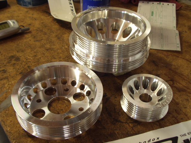

Well i had 8 voices in my head saying to install the pulleys, and one saying don't install the pulleys....i went with the majority.......and i'm happy i did.....the butt-dyno says "Hell yeah"......my voltage stays at about 13.9V......air conditioning works fine.......and after a little run at 125mph, i found the only increased vibration to exist at 6250 rpms and up........seeing as how i don't spend too much time in that range, i think i'm gonna be happy with this mod.......nice thing is, this is a show and go part.....here's a pic:

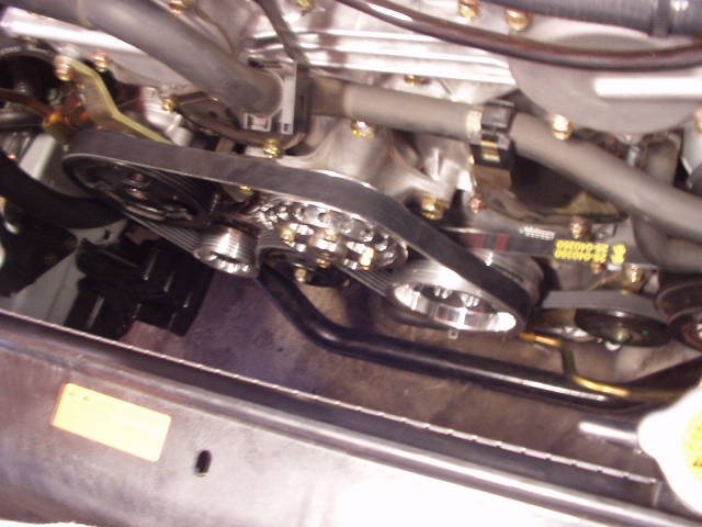

I used one belt that was shorter than what UR said to use......instead of the 040355, i used a 040350.....it was a PERFECT fit.....plenty of adjustment still.........here's a bad pic of my engine bay, keep in mind this pic doesn't do it justice:

Anti-seize is imperative......the pulleys are aluminum, and the crank is steel, so the tight fit demands it...........my guy used a chain wrench, a big ratchet, and breaker bars......this made it possible to do the install without pulling out the radiator, although the fan shroud did have to come out.......when using a chain wrench on the pulleys, he wrapped them with the original belt, to protect them from getting marred by the chain links.......the alternator had to be removed to install the pulley on it, since the stock and aluminum pulleys are both too small to get a decent grip on with the chain wrench while still attached to the motor.......my mechanic walked the original crank pulley off of the shaft with 2 flathead screwdrivers, for the impatient i would recommend a gear puller........and like i said before, we used a 040350 belt instead of the 040355 that U-R said to use.....the belt they suggested works, but it leaves no room for adjustment on the belt when it stretches
