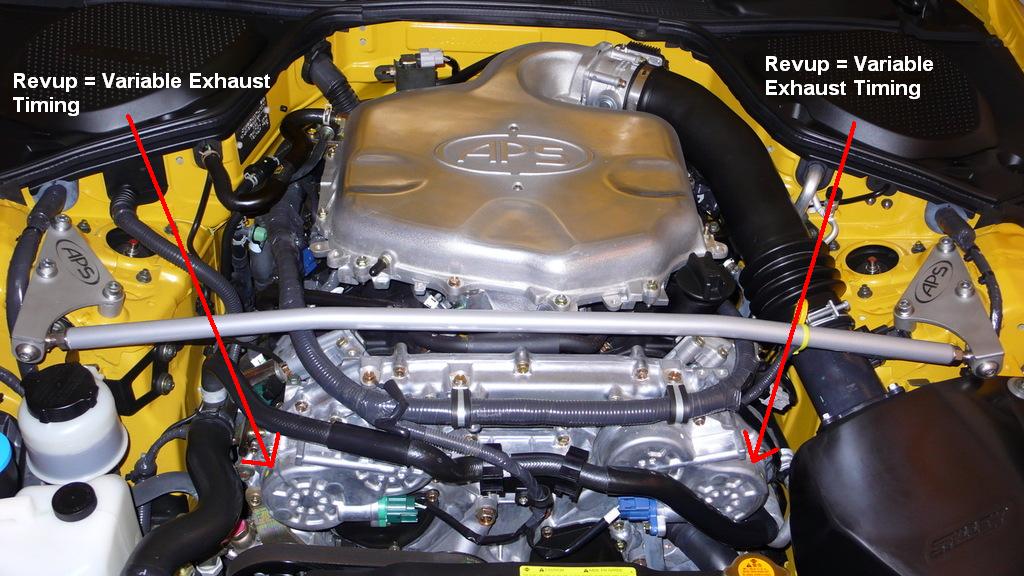

How can I tell if my 03 is revup or not?

where does your redline start??6600 is non revup and 7000 is revup (be ready for some bashing form other people its in the top 100 questions)

'03 should not be a revup, but if it was swapped for one, it'll have variable exhaust timing.

Ok guys. Yall are very kind for the help, but I've been here since 2002, have several mods listed in my sig, and over 500 posts. I was being sarcastic.
Guess I shold have raised my eyebrows more when I said it.

Very nice picture aids however gothchick. Thanks again.

Thanks for the photos. I learn something new every day here.
