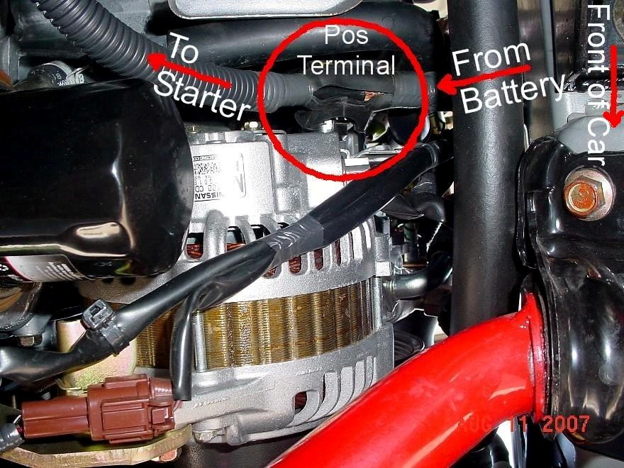

How do you connect 2 grounds wires to the Alt???
You don't. One wire is +, the other is -.

Back form the dead>
Sorry I meant to say (+) and (-) wires, not ground wires. Where exactly do connect the (+) and (-)wires on the Alt??
Back form the dead>
Ground to a mounting point (or the alternator body, if you can find a place to secure a lead), and a positive cable from the stock lead to the batt.
Back form the dead>
Here ya go~ :-)
