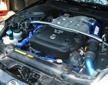

Ok, here's the story....
So me and my friend are replacing my hoses with the pretty SAMCO hoses below.... Darn they look nice.... Coupled with Insane's grounding kit... the Blues are dead on. I thin that AEM blue gots to go.... but I'll wait for Greddy's blue intake and turbo combo (looks like dual intakes).
Back to the hoses.... Well we bleed the system really well... have some problems with the small clamp hose. (Clamp seemed too small, but we got it on there with lube)... But we didn’t flag which way the original S hose connected the upper and lower port. (You cant even see it in a pic). So we debated over which end was which and got it on there.
After it was said and done, we had an extra samco elbow hose (If I couldn’t find the original to take off... why bother?) I still have been checking around the engine for where this hose can go.
Now the fun part, so were re-pressurizing the system.... gassing the car and what not.... and everything is running fine. (We checked for rubbing)
I then decided to do some hill country runs at 140+. Was thinking to myself damn this cars running cool.... Then it happened.... That damn S hose rubbed against an engine belt and burnt a hole. The Car's thermo jumped to H, and the ECU shut the engine down.
I coasted into a nice covered parking lot. So we got the car jacked up, and switched the blue hose with the original... noting which side rubbed, to avoid this from happening again. Once we got everything copasetic… the damn thermo wouldn’t kick in, and I thought it was shot. So my friend got in the car and gassed the hell out of the car…. He yelled “F#$% - a man” as I walked over to see the thermo drop from H to a nice midpoint.

Zip Pic 1

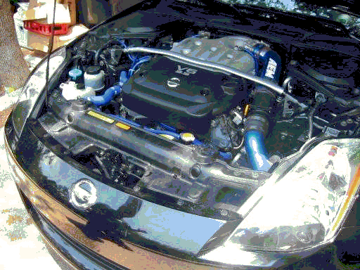

Default pic2
pic2

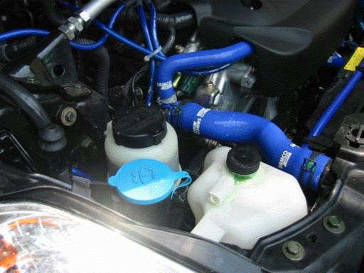

pic 3
