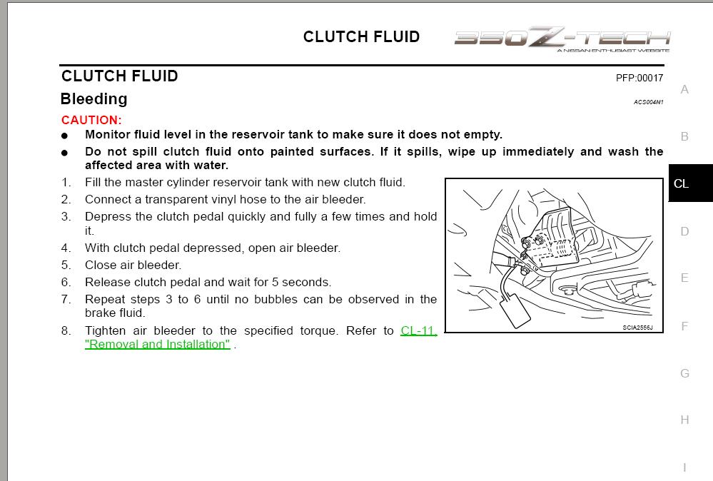

Might i suggest the FSM (FACTORY SERVICE MANUAL)
YOU CAN CLICKY HERE: http://www.nicoclub.com/FSM/350Z/
SEE SECTION CL - CLUTCH FLUID - BLEED
Attached Thumbnails Question about changing clutch fluid-bleed-clutch-fsm.jpg
