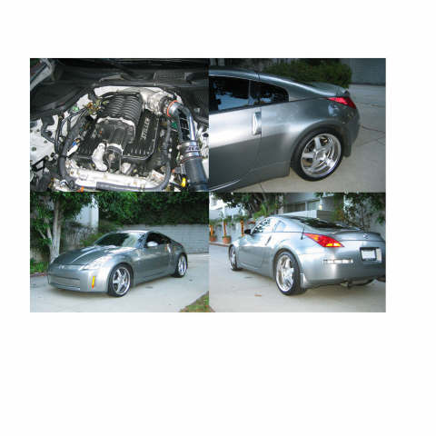

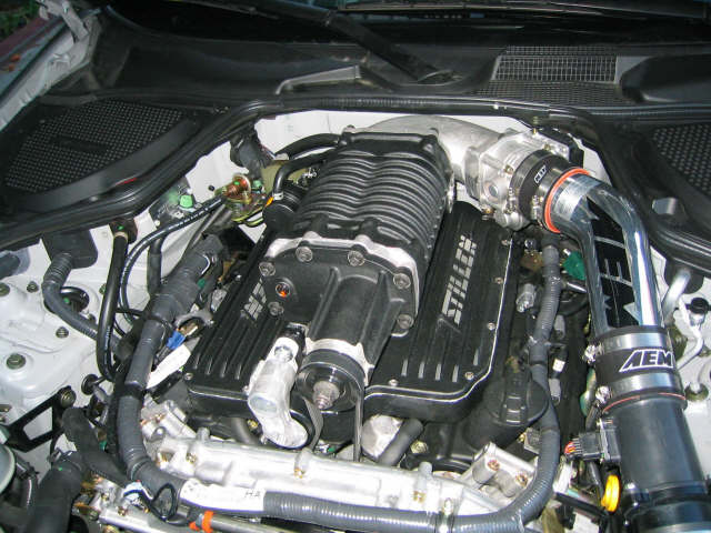

I actually took the car to Stillen today and they feel like it might be the AEM intake that is made of aluminum and heating the air too much that is causing the ping. Steve Millen himself took a look at the car and was very helpful. I am taking the car to them on Tuesday and leaving it with them until they fix it. But here are some pics and hopefully these pics come out ok. More updates to come. They did not Dyno the car but I saw a 307 RWHP dyno in 5th gear at 185 degrees of another guy's who has the supercharger installed .

more pics

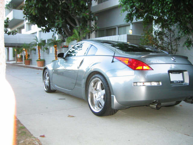

pics

my suggestion:
remove the inner fender block that is connecting the driverside fender area from the frontal inlet area (where your grille is)
this way, the AEM can get air while driving... i posted this b4 but i dont know if people have seen it.. but the way the front bumper is designed, the location of the AEM is not getting any fresh air and the intake temp just keeps climbing in the car even when driving.... a cure for this is to open that chamber to air flow from the front of the car.... this is the stagnation point of the car, aka there is a pressure zone created when the car is driving.. basically air will go to ANYWHERE you port it to.. so if i were you, i'd make some type of channel from the front of the car to where your AEM filter sits to get more cool air....

Car feels great with the charger. My only problem is the slight ping every once in a while. Has anyone experimented with any heat absorption covering for the AEM intake to allow it to cool a little since it is made of Aluminum? Any other easier fixes besides running some sort of additional cooling piping that leads to the intake. The temp on the car doesnt move at idle but plug in a diagnostic and the temp goes up about 20 degrees when idling at a light.
