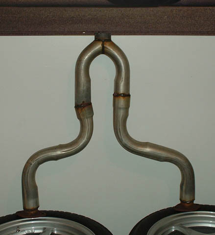

I got an O2 bung installed yesterday, just forward of the drivers side cat so I could get accurate readings and redyno'd with the special updated program. Now my a/f ratio is rich, running from as lean as 13:1 to as rich as 11.5:1 in the upper bands where they added more fuel. EVEN WITH THE ADDITIONAL FUEL, MY HP SEEMS TO BE CAPPED AT 238. No matter what I have tried since I installed the 'corner muffler shop' made y pipe, I can't get past 238 hp. My Y pipe is a prebent piece, shaped like a U, such that each bank of cylinders airflow meet head to head, then while opposing each other, have to make a 90 degree turn to exit to the midpipe.

Default oh yeah,
the picture of my old y-pipe, as you can see, it reached a bottleneck at the Y/ Thats what I get for being an early adapter and not waiting for a proper system to come out.

Yeah, that thing is ugly! No offense, glad you are happy now. I still have not bitten on the ECU yet. I'm next going for 2.25 cat pipes and then maybe this ECU. I noticed a great difference when I went to the Borla Dual.

Man !!!! No offense but I would even stick that Pipping on an Escort. That thing is Fugly. Glad to see that you put the stock system back on and happy with the ECU

woohoo! now people can stop bashing the TS ecu based on some inaccurate readings. i knew it all along. i even said it in the first thread. I said it was the y-pipe and guess what!!!!!!!!!
