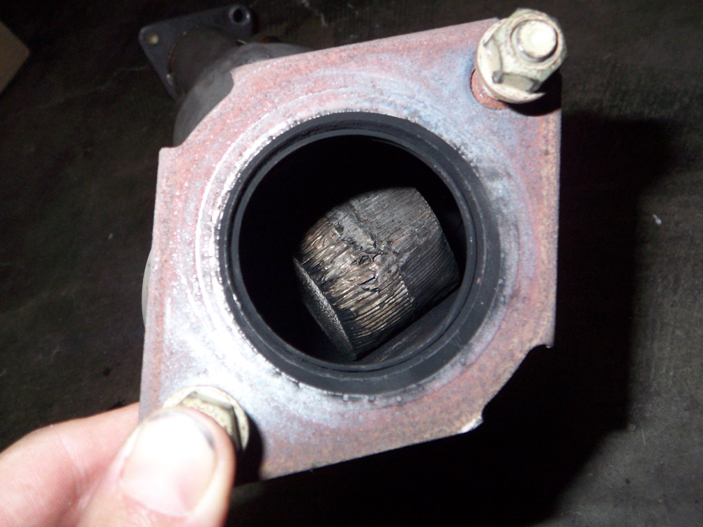

UPDATE!
My tuner kept at it for a day and finally found the problem.
The catalyst became loose and was plugging up the drivers side cat-exhaust flow.
The material isn't melted or broken, but whatever was holding it in place no longer is, because its just rattling around in there.
Personally I thought there would be a lot more catalyst in there than just a round 2 inch wide piece.
Thanks, you 350z guys have definitely helped me out the most online.
~Dv8

relatively simple....good stuff all things considered

Cool glad you found the problem.....luckily for me mine just just burnt up and there was hardly anything left.

Brand New Berks installed, no more issues. The other stock cat was showing some signs of going as well. Not a whole lot of catalyst in stock cats, I was surprised.
No CEL/MIL on the Berks. Seems to hit same boost psi as before maybe a little less. I'll take some logs later. Im getting the car back on the dyno soon to fine tune the new HFC's.

Nice detective work especially without a code to help out. A blocked exhaust is not something that would have come to mind. Kudos go to your tuner.

Wow...catalyst problems....same thing happened to me....my tuner was wondering why my car was pinging during boost, and we found out the stock cats were burned out/melted and all this crap came out of the cats when I took it off my car....switched to crawfords and no problems (except for a little unwanted rasp)...
I guess I'm kinda hijacking the thread (congrats on fixing the problem OP), but anyone else experience bad stock cats? I mean I only had 50k miles when my stocks cats went bad...what's up with the stock nissan cats?!

I'm almost at 50k myself. Only 2k of its been SC'ed and one of the cats fell apart inside.

That's not the first time I've seen that with stock cats.
The same thing happened to an FX driver at 20K miles.
