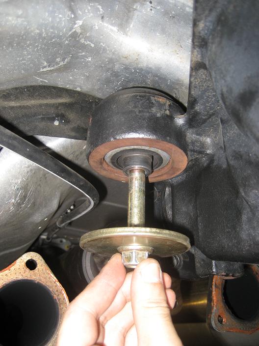

Think I have a problem ... should there be a rubber bushing between the washer and the bottom of the diff mount? From memory I think there is, but don't have the original mounting hardware anymore to tell if I'm missing one or not. Can someone post a pic of their pumpkin OEM mounts?
Thanks!!

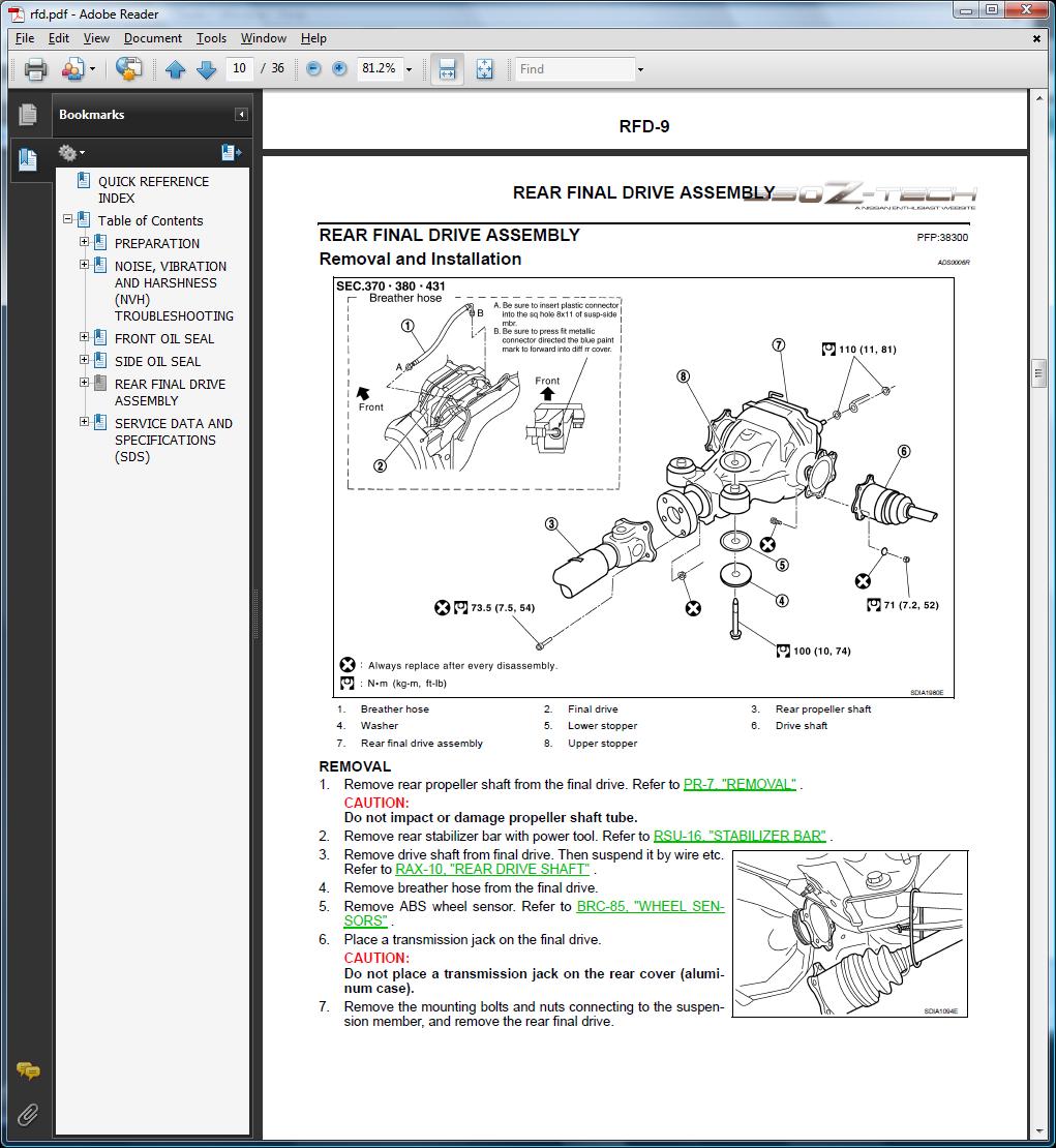

Crapola... I'm missing the upper and lower stoppers according to the service manual. F-ing F. ****. And Nissan parts is closed today. ****.
