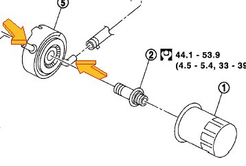

What if you were to tap into the existing oil cooler lines. My 04 G35s has one, and according to the Z service manual it does too. They are hard lines connected using rubber hoses. You may be able to get the hard lines flared on two of the ends and tap in with a nice stainless line setup there. this would save in needing another/different sandwich plate. just a thought:-)

If you're talking about the two hardlines pointed to in the picture below, those are water lines for coolant to flow through. It is a very rudimentary oil cooler that nissan incorporated. Unfortunately, no oil flows through those lines to tap into for the oil cooler.

Thanks for straightening that out. i mistook the text in the manual (probably read to fast,lol). I took it as those were oil lines routed through cooling system, rather than cooling lines routed through oil system.
