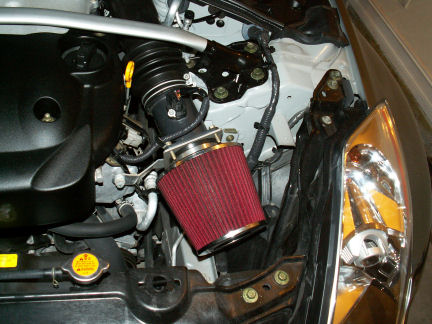

Just purchased 2005 350z and my friend purchased a 2003 Z. We switched and drove each others cars and I was amazed how much more punch his had when you gave it gas. Both of our cars are stock touring editions, except mine is the 35th anniversary. Mine also has an aftermarket air filter (stock airbox is removed). I'm wondering if the problem is the aftermarket air filter and I would like to find a stock air box and change it back. Do you think this is the problem or should I look elsewhere? Help, my friend is giving me hell for having a new Z with less miles and ...less git up and go!

What kind of aftermarket intake do you have? Is there a name on it or is a no name? Got pics? Is there a heatshield?

It's a no name and it doesn't have a heat shield. Here's a pic.

Get a stock intake box and go from there You're heat soaking your engine quite a bit with that intake.

Most aftermarket intakes will actually lose power on the Z's. Try your stock airbox as TheFarmer stated.

David, I think the chance of a glycol fire is remote at best, so I wouldn't be offering that as the reason why heat soak is bad. LOL. The more obvious and practical detrimental effect is decreased performance from lowered mass air, which is what you were responding to anyway.
For the OP, if the car is hesitating, then something may be off with the tune. You can try an ECU reset (battery disconnect overnight) to see if the computer can readjust trims appropriately. You may also want to check for vacuum leaks in the intake system or exhaust leaks (which can lead to erroneous AFR feedback).

Thanks folks! I plan to switch back to the stock airbox just as soon as I can find one for sale. Nissan wants your first born to buy one new so I need to find a used one. If that doesn't cure it I will start looking for leaks and reset the ECU. I'll let ya know what happens.

It's a miracle! Bought a stock airbox from a forum member and installed it last night. The old girl has got some pep in her step now! The difference is like night and day. Thanks for everyone's assistance. Just wait til I see my friend and his 03. I'm gonna blow his doors off!
