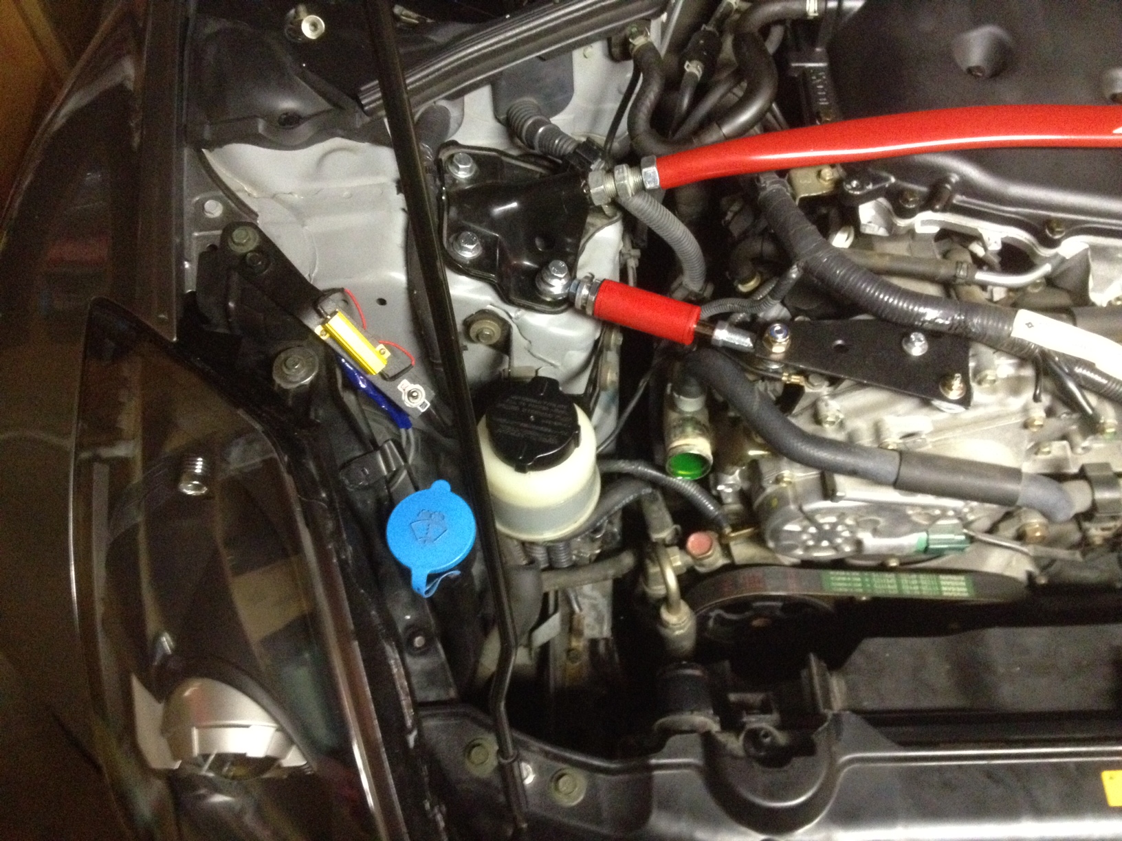

Here is my set-up, found new locations, fabbed a sheet metal part and did my own..
Attached Thumbnails engine torque damper-damper-1.jpg   engine torque damper-damper-2.jpg
