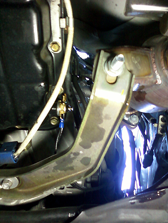

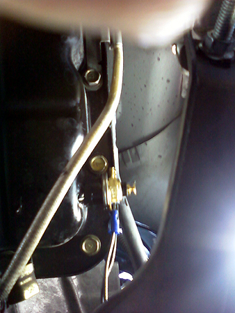

pix of transmission fluid sensor installed are below. i only drove the car for a day before dropping it off at the shop for yet more paint work, but the AT fluid temps were pretty close to the engine oil temps. i'll post up more results when i get the car back next weekend.
looking up and forward at ATF pan and part of the passenger side cat. the front of the car is towards the bottom of the photos
