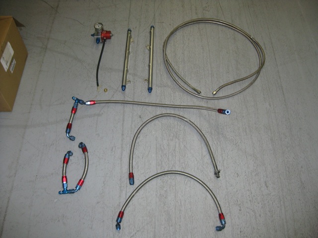

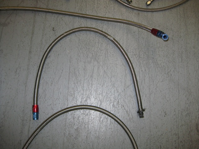

Ok... I bought this Stage 1 fuel return kit from some douche bag on this forum(Thank God I didnt buy the supercharger from him). There seems to be something missing but when I look at pics the lines are all coiled up so I cant really tell. The fuel pump is not pictured but its missing the fuel level float. Here's pics.. thanks.

looks complete, as long as your have the parts your use on the fuel bucket, like the drilled out regulator, and the return fittings that u drill into the top of the bucket.
it doesnt come with the float, you reuse your stock one.

Your also missing the fuel line adapter. It originally came with a 90 to 5/16 barb fitting made of plastic. I used a Russel Fuel Line adapter and 6 AN straight fitting for a cleaner installation.

Thanks Guys... Str8dum1 I'm good with the bucket and now I know what HotRodG35 is referring to. To be 100% honest I want to complete the kit to sell it w/o being a dirt bag, I bought a CJM Stage 1 and I already have a new 255 Walbro.
