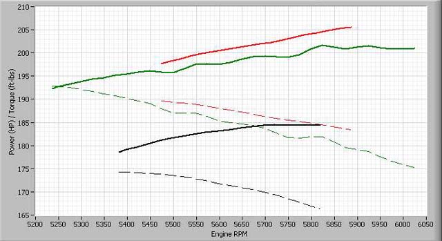

I've heard a lot of opinions about underdrive pulleys on this forum - from they're great to they don't do a thing.
Here are the results of my test. Before the pulley kit install I only had a NISMO CAI mod. I installed the pulley kit this weekend, and ran this comparison test with my G-Tech Pro Comp. today.
The black shows my average baseline runs with just the CAI, and the red and green are from today with the pulley kit installed.
Attached Thumbnails UR underdrive pulleys test-baseline-black-vs.-underdrive-pulleys-red-and-green-cropped.jpg

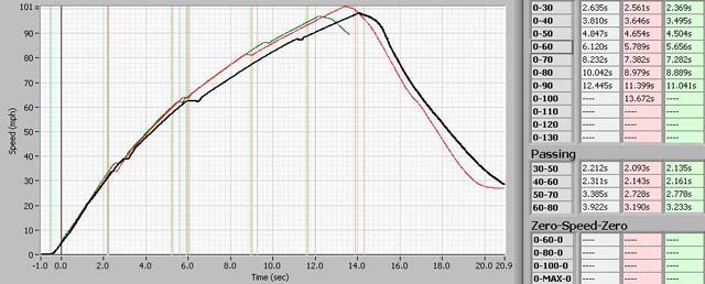

And here are the HP & TQ numbers.
Attached Thumbnails UR underdrive pulleys test-baseline-black-vs.-underdrive-pulleys-red-and-green-hp-and-tq-cropped.jpg
Old Nov 17, 2003 | 10:17 PM
roark's Avatar
roark
Posts: 628
From: Va Beach
Oh, in case you're looking at the tables and wondering why my car seems so slow in the 0-60 range, it's because for some reason my g-tech, when calculating that value, does not account for the roll out. All of the other numbers are accurate, and if you export the run, the export file shows it correctly.
Anyone else have this problem with their G-Tech Pro Comp.?

Old Nov 18, 2003 | 07:47 AM
Darin's Avatar
Darin
Posts: 29
From: IL
Nice testing - but were the test conditions the same when you ran the original test as now? Weather (temperature and barometric pressure, etc.) has a significant effect on power, and since the tests apear to be on different days I had to ask, as a nearly 20whp gain from pulleys seems a little optimistic.

Old Nov 18, 2003 | 05:02 PM
roark's Avatar
roark
Posts: 628
From: Va Beach
In the first run, the BP was 30.04 and the temperature was 78 degrees f. On the runs after the pulley install, the BP was 30.80 temperature was 75 degrees f.
So, I suspect that environment could acount for 1 or 2 HP, but that's about it.
Also, last Friday I dyno'd the car just before the pulley install. I'm going to dyno again, first to confirm what the G-Tech is showing, and second to get a new baseline for my next round of mods (Headers, exhaust and TB.)

baro going from 30.04 to 30.80 is equivalent to being 760' higher elevation, so that should wipe out any gains from the 3 degree cooler temp.

You mean lower elevation right? 30.80 is higher pressure (as if you were at lower elevation), so that added even more power outside of the pulleys. Using the rule of thumb, 3% difference in power for 1000' elevation, this was probably around 4-5hp that we would subtract off just for the baro difference.

OK, I took all of my values and ran them through the SAE correction factor calculator at
http://www.csgnetwork.com/relhumhpcalc.html
And applied these correction factors to what the G-Tech shows. At the low end of the graph above, I'm seeing a corrected increase of 9.0 HP and at the upper end of that graph, I'm seeing a corrected increase of 12.7 HP.
Next, I exported both of these runs to a spreadsheet, SAE corrected, and averaged the diffence of the runs, I get an average of 11.9 HP and a peak 14.6 HP gain between 3K and 6K rpms.
So, is this a good mod? Well, the pulley kit cost $300 shipped from Coz at Concept Z performance. 300/14.6 = $21/HP = a good mod in my book.
Oh, and your rule of thumb is close according to that calculator. It says 4.5% difference between 0'-1000' but since air pressure does not decrease linearly with altitude, I'd say you're good, especially higher up.
So why the discrepancy between what I see and the dyno discussed above? My guess is that they dyno'd immediately after installing the pulleys. I let the car run for a day before I ran my test. It's peculiar how our ECU will do that - but that's another thread entirely.
I performed an ECU reset, then ran G-Tech tests each day for the next 5 days. For the first two days I saw very noticable performence changes, then the diffences were nominal enough to be factored out by environment. Each day consisted of aproximately 50 miles of mixed driving.
