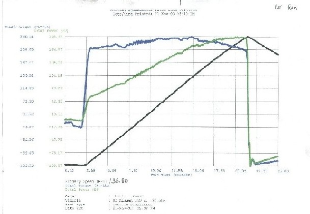

Can someone familiar with dynos please explain these results to me and what may have affected this pull.
1st Pull: 195.27 HP
280.04 TQ
2nd Pull: 200.4 HP
286.67 TQ
I am new to dynos, however, I know this can't be right. Any help ideas would be greatly appreciated.
Attached Thumbnails Mustang Dynamometer Results-friday-november-21-2003-2-resized.jpg

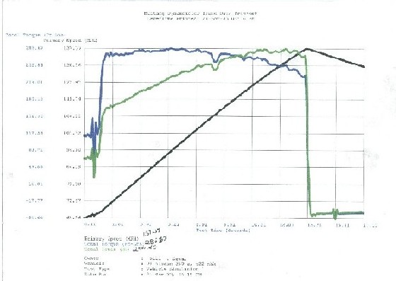

Old Nov 21, 2003 | 04:06 PM
done12many2's Avatar
done12many2
iTrader: (33)
Posts: 616
From: North Carolina
1st Pull
Attached Thumbnails Mustang Dynamometer Results-friday-november-21-2003-resized.jpg

What affected the pulls? The fact that it was a mustang dyno, that's all. Go get it done on a dynojet and you'll see completely different results.

Does that mean that Mustang Dynos are not the preferred dyno?

Is it me, or are the TQ numbers all out of whack?

They're fine dyno's, just give some really wacky results. Supposedly they're more accurate from run to run on the same car and the same dyno than others, but we've seen 300HP dyno's from a Mustang on a normally aspirated car. While we saw close to the same numbers with a 350z that had the Vortech SC installed. Two different dyno's though.

Everything is all out of whack. Your numbers should be around 230HP, unless you're dynoing the car on top of Mt Everest.

Sounds like the gearing was entered incorrectly into the dyno. Just a guess

I think a major contributing factor is the fact that the individuals operating the machine did not sound too sure about anything they said!
