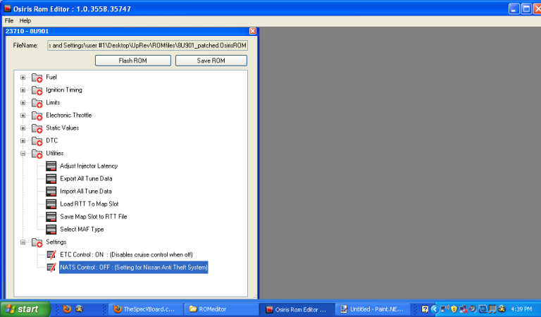

Just a FYI djamps. The NATS goes through the BCM and then to the ECU. Been down this path before with a client that tried to install a turbo timer and shorted out the NATS ring and the BCM.
Now if you want to Get a round NATS, you can have a Osiris Pro dealer disable it in the flash. This is the only way I know around it.
