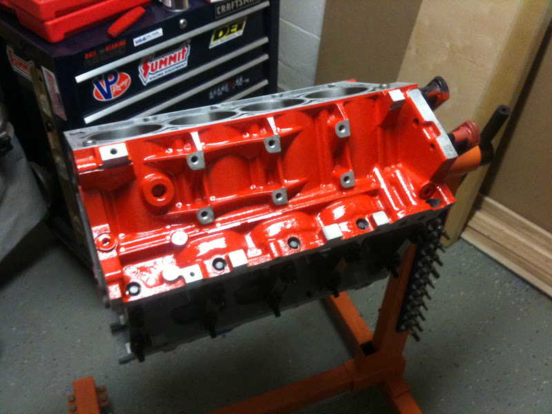

Freshly Cleaned, Bored, Honed Block:
Is that Chevy Red-Orange I see:
Why yes, yes it is:

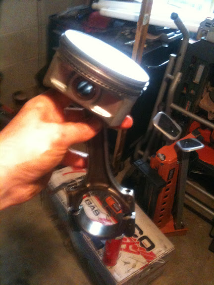

Piston Assemblies:
New Piston Assembly with ARP Rod bolts and MAHLE Pistons:

The rod bearings and connecting rod/piston assembly.
Dropped in the rod bearings.
Bearings are ready for clearance inspection. Seven more to go...
All the Piston/Rod assemblies ready for rings.
My piston ring squaring tool works!!
Piston ring #3 all gapped up and ready to go.
The full piston assembly rings, rods, bearings, and pistons. The whole caboodle ready for assembly.
