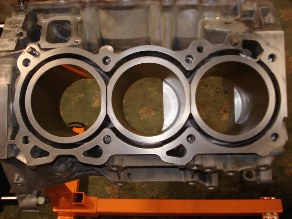

I believe the images below show what is required for HR gaskets
Attached Thumbnails Built Shortblock Assembly Questions-zenginebuild003.jpg   Built Shortblock Assembly Questions-zenginebuild009.jpg   Built Shortblock Assembly Questions-zenginebuild010.jpg   Built Shortblock Assembly Questions-zenginebuild025.jpg
Wait a sec - is that headgasket in the last pic the HR gasket or the DE gasket? Does the HR gasket have the extra hole or is it the DE gasket that has the extra hole?
