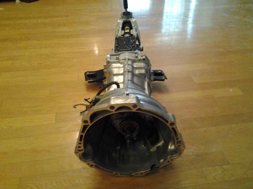

Here's a pic of the tranny. I'll check into the JWT set up. Where should I be looking for best pricing and what model or part id.? Honestly I was looking for something on ther lower end around $400, but if they're junk I wont waste my $$. Even with mods I don't think I'm going to go above 400hp.
Wow, that was pretty informative... so noone knows if these $400 kits are crap for street use. I'm not tracking the car. The JWT seems a little overkill for daily driving. My driving consists of in traffic doing 25mph on the freeway, letting a little loose here and there 140mph+, when there's absolutely noone out, and dropping the clutch here and there in town. I'm not dragging against subis.
