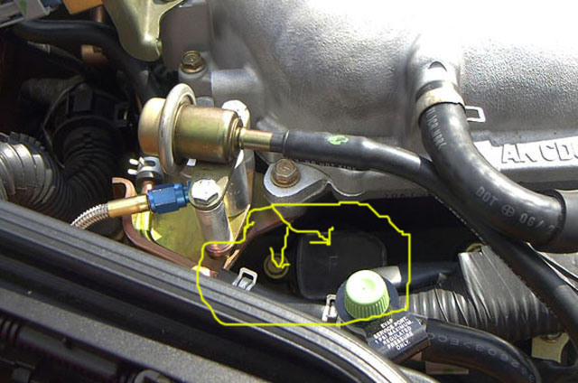

how do i access my spark plugs to change them?

very easy...heres a pic..Remove the 10mm bolts holding each coil..# on each side..pic 1 is drivers side#1 and pic 2 is passenger side #5...You will need a sparkplug socket and a 6-8"extension..

make sure you go 1 degree cooler plug..preferably the NGK LFR6A-11 from sparkplugs.com..

dont forget to put a little anti-seize on the plugs

took me about an hour because i had to move so many wires/hoses around to access the plugs
and i had to remove my intake tube also
pretty straight-forward, just a little time-consuming.

The LFR6A plug is not iridium, it is a standard plug just 1 degree colder... I swapped mine a few weeks ago at 40,000 miles and they made a big difference. Also the stock gaps were all over the place, anywhere from .040-.050....... There is no way I would wait 100,000 before changing the plugs... Also, anti-seize is a grease that should be put on the plug threads whenever installing new plugs so you can change them again in the future. It protects the threads against heat and water .... You also want to put some dialetric grease in the plug boots.....
