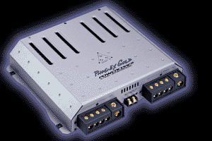

I am running a 1200.1 at 1 ohm and a 600 watt Alpine at 4 ohms with TV/DVD/ 2 DVC L7's 1800w total rms and I only have 2 Farads, look elsewhere to solve your problem like a 15 Farad PG Power Core or something. Only 600 bucks and you will never need more power.
