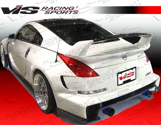

I have a question for y'all. Does anyone know the extra width of the VIS overfenders?
http://www.visracing.com/newcatalog/...t-Fenders.html
http://www.visracing.com/newcatalog/...r-Fenders.html
I'd like to get moar tire under the car, and really don't want to learn sheet metal work to do it

i'm not sure if it's the same or not, but Kingbaby added rear overfenders.
https://my350z.com/forum/nismo-350z/...-linda-43.html
