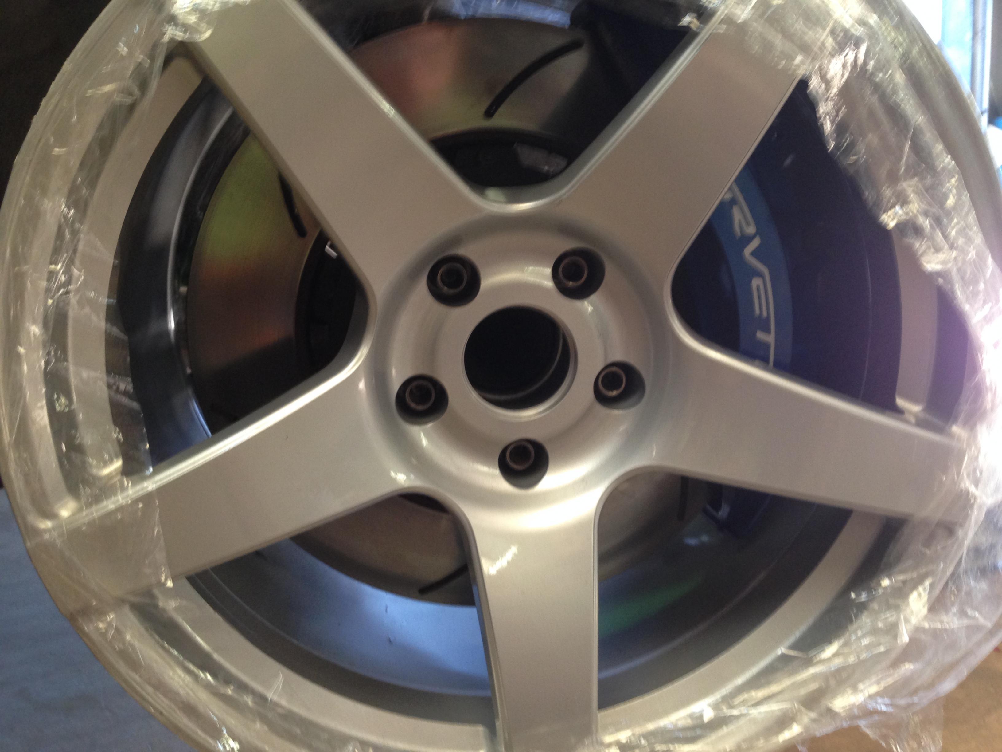

its been busy lately with Birthdays, and prepping for Znationals, but here is a small tease of what I've been toying with.
This is a 388mm front GT-R rotor with a new Corvette ZR1 caliper.... under my 18" forgestars....
Will get back to the rest of the swap in a week or two, incredibly busy with my better half's birthday and preparing the track day for ZNationals.

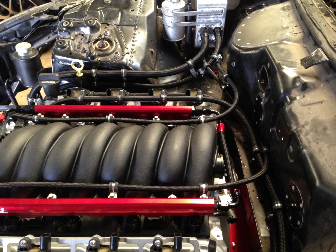

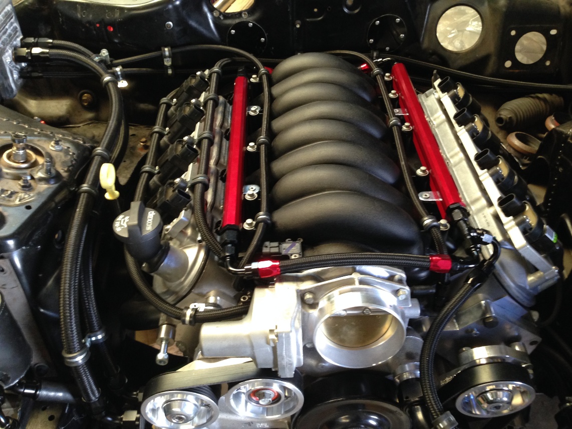

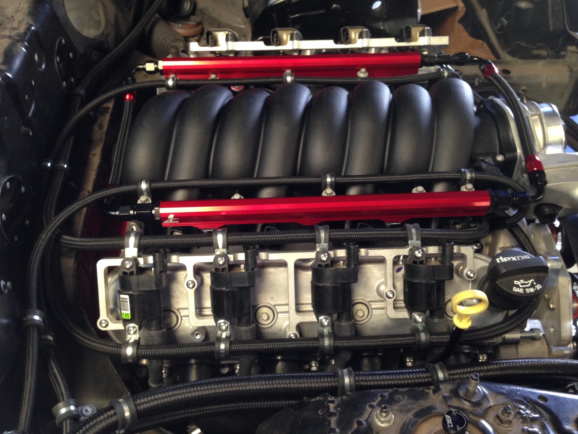

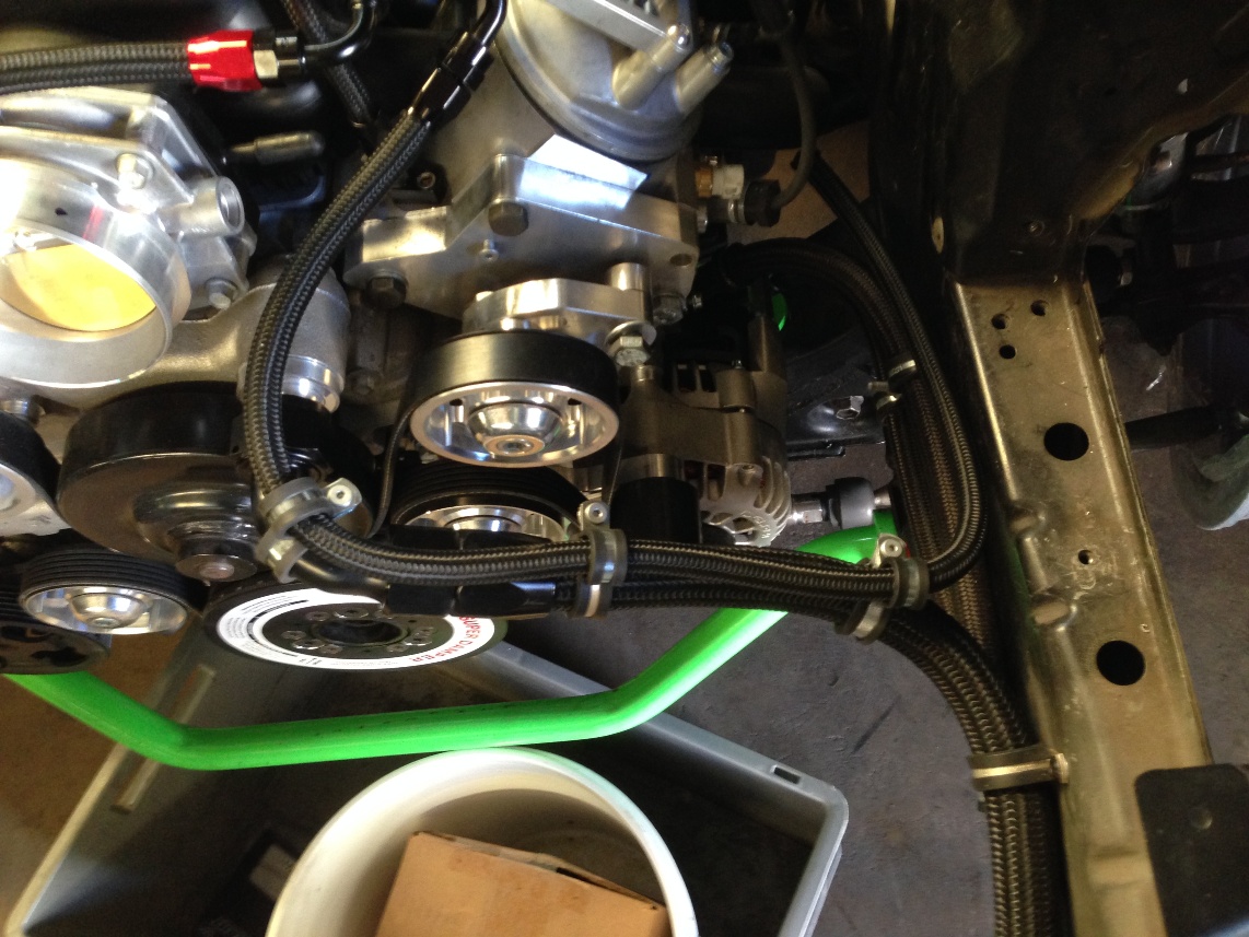

Default 10/4/14 plumbing update
Well I just about finished the engine plumbing, still need to mount my bulkhead fittings in the rail, but other than that, I'm pretty pleased with the results.

Default Brakes
Its been a couple of months since my last update, so here is what I've been working on. Mike the Powdercoater did the Green for me.
rear - don't mind the weld splatter on the rotor, that is a mock up piece
Fronts

Default more brakes
calipers and wheels
The lettering has a reflective element to it, i expect that will roast off on the first really hot braking zone.
Fronts
Rears

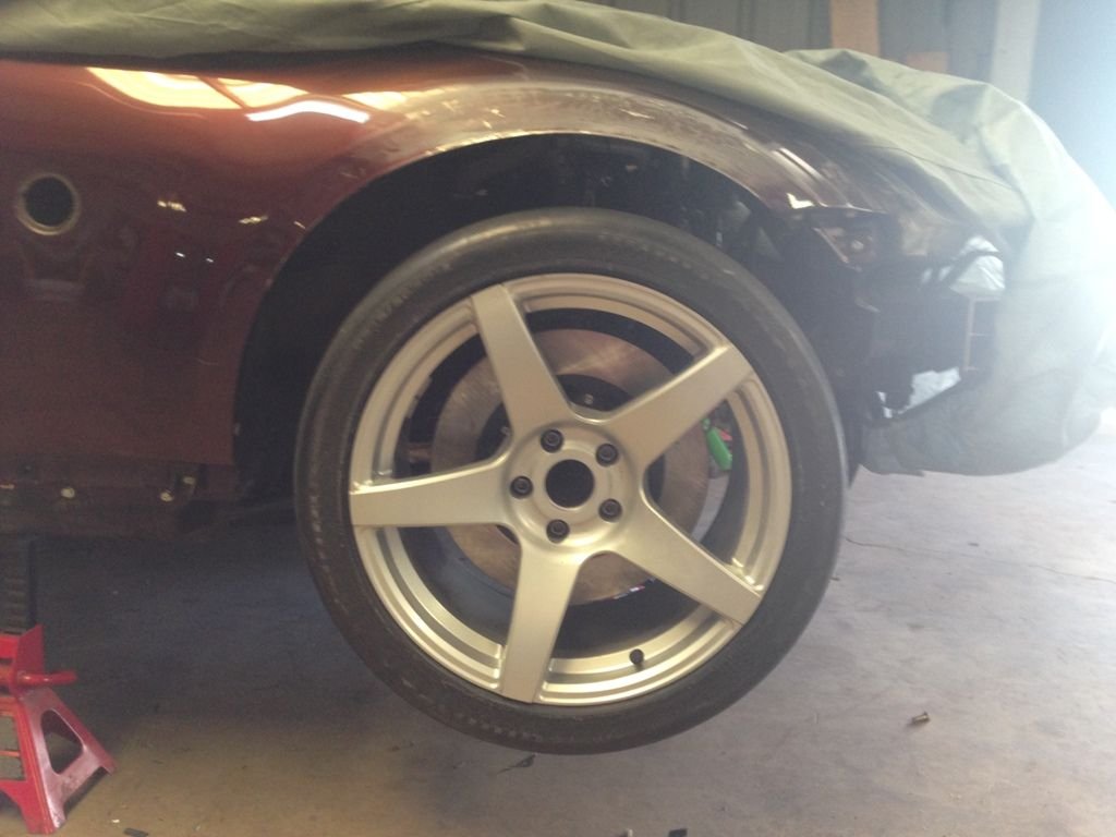

Default quick update
Ordered some tires and started pulling the fenders to clear.
18x11 +13 with a 315/30ZR18 at Full droop, unsure of exact camber at the moment
18x12 +29 with a 335/30ZR18 at Full droop, unsure of exact camber at the moment
