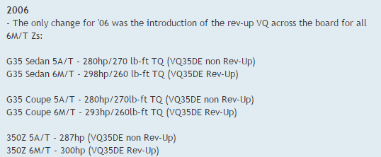

are you sure it is not a revup? i thought that all 06's had them, unless it came from an automatic
http://forums.nicoclub.com/g35-350z-...s-t327050.html

travlee, I am sure its not a revup, so I guess that i have an automatic engine, I only have vvt on my intake cams.

So I am assuming that I do have an automatic motor, is there anything different about the AT engine that I need to be aware of? Cams, timing?
