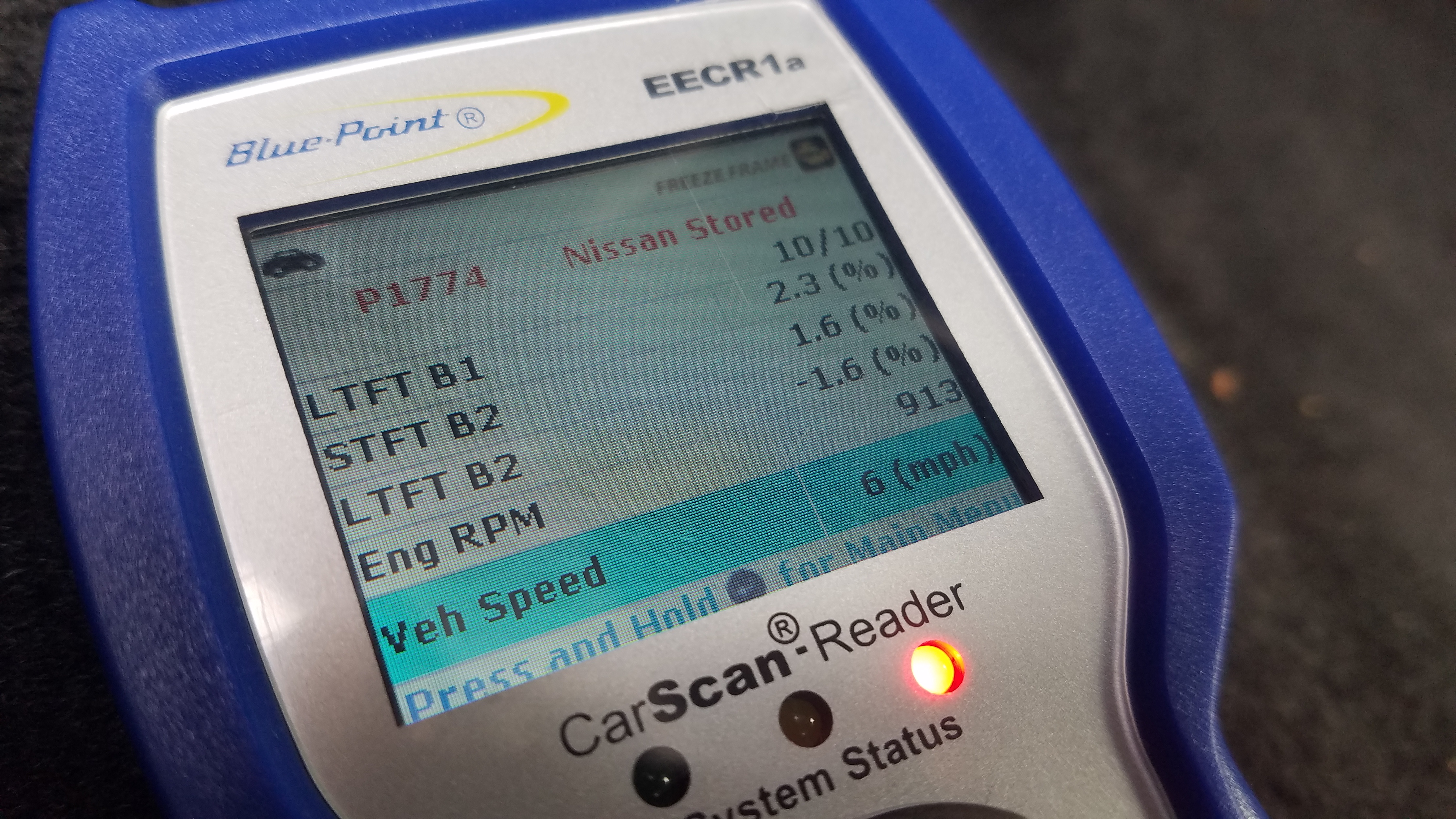

P1774 - Low Coast Brake Solenoid Valve Function

From what I'm reading this could be a connector to the Low Coast Brake Solenoid, the Low Coast Brake Solenoid control circuit is shorting out or stuck open, the Low Coast Brake Solenoid has failed, or the A/T pressure switch #2 has failed (or a combination of those issues).
I cleared the code, light is off, I'll see if it comes back.
Unfortunately I'm not familiar enough with this system to know the lowest cost solution if it does act up again. It's looking like it'll depend on if that control circuit and connector is replaceable or if it's part of the valve assembly.
