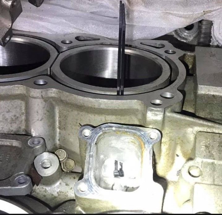

Just in case anyone is still curious about this, a guy called Charles replied to a thread I started on facebook about this and they took some photos that show exactly how this is connected. The holes are quite high up in the sides of this area we've been talking about and coolant actually flows DOWN into that area, which is not something I'd ever considered at all, and explains everything.
After seeing this, looking back at my original photos and videos it seems really obvious now lol but yeah, end result is that all of the VQ35 engines are open in this area and the pathfinder mod does work as intended on all engines, not just US ones.
I've got to say though, it does make me question how useful the mod is... because the logic I've always seen people say is that the coolant goes to the rear cylinders and then has no easy escape route, so this mod adds that. As shown in the diagrams below:
On the blog post where those images were taken from, they say: "the coolant flows from the front of the engine to the rear cylinders and has nowhere else to go". Then regarding the pathfinder setup they say "If you follow the same flow, from the water pump and into the engine block, you’ll find that the coolant now has a “back door” out of the block". But I think the diagrams are very misleading and I can now see that the coolant flows up out of those rear cylinders and into the heads (just like all the other cylinders), and on its way some of it drops into this area that feeds the pathfinder mod thermostat etc.
So if this mod isn't actually adding a back door allowing coolant to escape that couldn't escape before, what is it doing? Also someone just pointed out to me that the HR and VHR don't even have this option (i.e. there's no blanking cap for you to remove and replace with anything else), so Nissan can't have thought it was that useful
Chris - I agree with most of what youre saying and I think this mod is helpful. Necessary? no, but helpful.
I think the diagrams are misleading too and I do think you're giving the coolant a 'back-door' or just a 3rd door to cycle through. Not that the OEM pump provides so much flow that the two coolant passages in the heads are insufficient but allowing coolant to find it's way out of the lower portions of cylinder jackets is a step in the right direction.
Ive learned not to attempt to think like an OEM ... I 'speculate' that nissan did not put this modification on the 350z/g35/maxima/altimas/murano/FX/M/etc because it was unnecessary and the cost of doing this to many many many vehicles outweighed the benefits. If it saved $100 per vehicle in materials/labor/warranty risk and was deleted from the 10s of millions of engines used between ~2003 and ~2008 that is a significant cost savings. We all know that cost was a serious factor when nissan decided to bring the Z back from the dead.
So to eliminate as many of these unnecessary mechanisms was a step in the right direction.

Hi guys,
Drilled this evening holes for the pathfinder mod. I had no holes. Talking about a v4y711 build in Renault which are basicly vq35de Altima engines. I drilled the holes in a bricked block so I could practice where to place em. The reason my study object was bricked were cooling issues in the rear end of the block.
Make sure aluminium drilling chips are cleaned. I used a vacuum cleaner. The holes need some adjustments with a grinder. But I know where to drill. One could easily mistake the bottom protrusion for the place to drill. If you do that you drill straight in the oil line.....

Originally Posted by Geerts
Hi guys,
I guess you didnt actually read this thread then lol the conclusion we all came to was that there are already holes there and you do not need to drill anything. The existing holes are in the side and you can't see them from the top but look at the photos in post 23 and you'll get the idea
I know ChrisDe, but I also read there was someone pooring fluid in which did not flow away. In my engine it's obvious there was no connection. The first post in this thread stated no holes in the engine even though they are easily seen on the pic. Therefore I posted mine my block had no holes and no blank plate on top. Now it has.
I stumbled upon this thread after I drilled the holes. Since it bothered me no one was talking about drilling when dicussing the pathfinder mod. I figured it out myself. But thanx to the 350Z guys bringing this up! I suffered from severe cooling issues and besides this mod I am gonna run with waterless coolant. I also changed the ceramic catalitic (close couple) converters for metal based.
