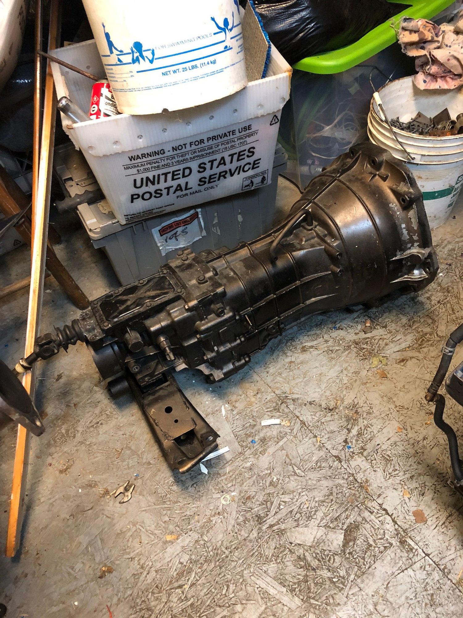

I put a new trans on my 350z forgot to put the breather on before I bolted it up now I can’t find where the other end goes if anybody has pictures or knows where let me know please thanks in advance

manual, in the picture it looks like it runs from the trans to somewhere back towards the rear of the car but I cant find the other nipple for the hose to slide on

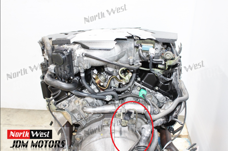

Rusty is correct. I managed to find some pictures to make it easier for you to see what he is talking about.

there is a metal tube bracket that the hose connects to and is secured in place by 1 of the upper bell housing bolts.

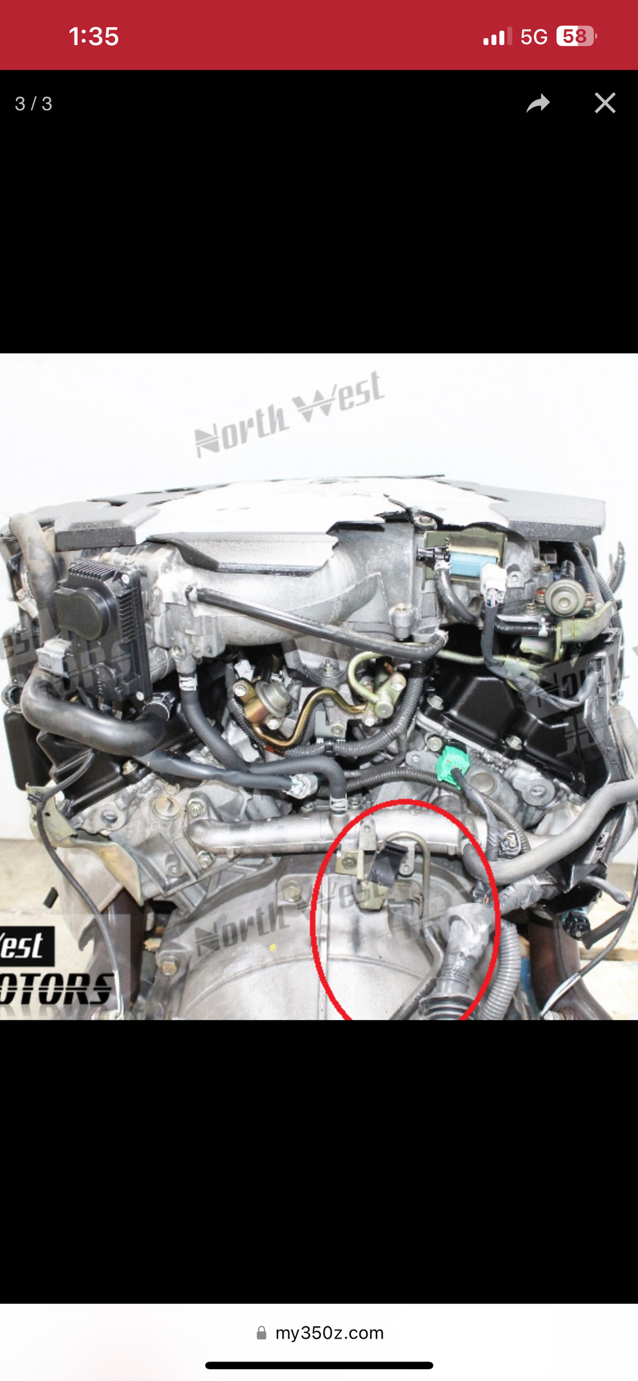

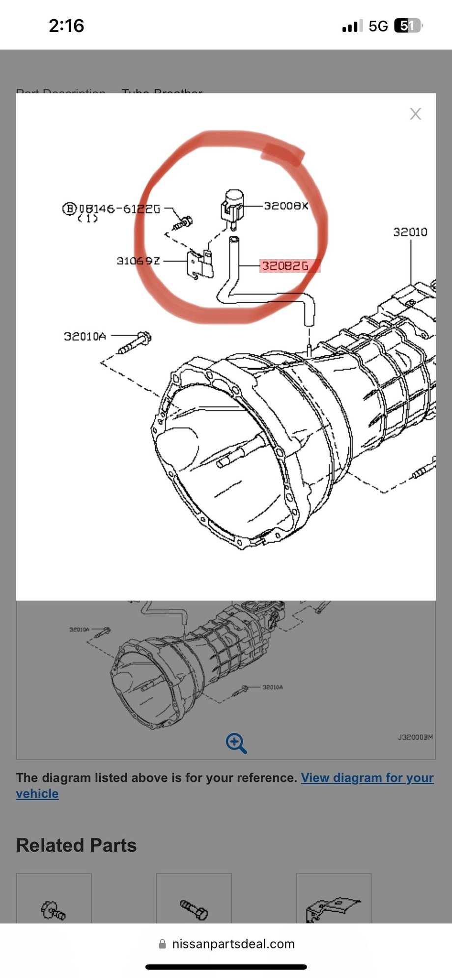

What is that bracket called which connects to the breather hose to the transmission.
does anyone know what part this is in the red circle?

its literally in the picture... jeebus
it may have been replaced with a different part number though

i dont think youll have an issue without it. All it is a vent that comes from the transmission to that bracket which should have a one way valve to vent out and wont let water/dirt back in. What you can do for piece of mind is just run a hose from that transmission fitting up into the firewall high enough so water doesnt get in and your set. OR just but the missing part with the part numbers above and call it a day
