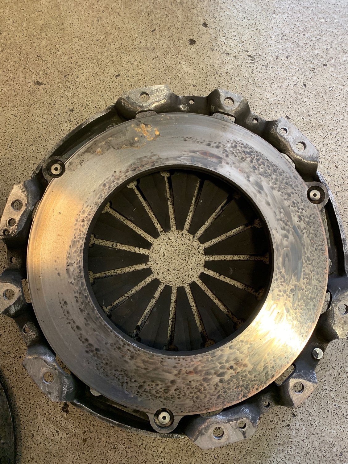

So I just bought a new Jim Wolf clutch for my 2003 enthusiast and drove on it for about 2k miles. Brought the car to the dealer and they tell me I need a new clutch and texted me the first two pictures I attached indicating the thickness of the clutch. I responded by explaining that I literally just bought a new one. He says it was probably I shitting or wrong fitting clutch (which neither of those are true). Then, 30 mins later he says the clutch might be alright saying "we're trying to figure out what's going on because it looks like it's only hitting half the clutch and fly will just buy the burn marks" He also said the clutch appears to stay engaged while driving, ultimately wearing on both sides and send the other two pictures. He also said that something is definitely wrong since rubbing is going on... Based on the pictures does that clutch look okay to put back into the car or do I need to replace it? I don't ride the clutch at all so I feel like the dealer is just trying to pull a fast one on me.

Not trying to be mean, but do you know how to properly drive a manual? That clutch has been abused far beyond normal and the surface of the flywheel is probably warped. To answer your question, YES you need a new clutch and flywheel but before you go changing them you need to assess what you are doing wrong or causing that to happen, I am at 93k with the same clutch.

Improperly torqued pressure plate or clutch fork installed incorrectly - also inspect the pivot ball. Is it the correct one for your year? There’s obvious friction problems.
So why is the dealer messing with it? Why didn’t you take it back to the “reputable” shop that did the work in the first place?

This seems to be a step that everyone misses the majority of the time - It's possible that the push rod for the master was not properly adjusted after install. It appears to be on point with what you're describing:

In addition to a probable misaligned clutch pedal (partial disengagement) it does appear the only contact point on the flywheel is the very thin line at the outer edge of the flywheel. I noticed you didn't state whether or not you replaced the flywheel or rather the replacement friction surface. If the flywheel is excessively worn, it can't engage with the disc surface.
I'd replace the flywheel friction surface and install a new clutch. Your shop didn't do you any favors by not advising that to begin with. That clutch didn't stand a chance to last.
When you get it sorted, do yourself a favor and drive as though you have a glass of water on the hood and you're trying not to spill it for 500 city miles before you go to WOT.
This ^^^ is great info and possible cause for sure!

What did you do? Thought shop did the whole install? Not pointing fingers but if you did part of the job, the shop has an out. "Well, you did the _________ so it's not our fault. Classic finger pointing. Had guys come into the shop with problems and when stories were inconsistent (many a time), I always got the truth out of them... "Well, I tried to change the frammowitz but I think the Autozone guy gave me the wrong part." That's usually about the time the wife steps in and says, "Just pay to get it fixed, moron, I gotta use the car to drive junior to school!" and I write up a work order.
Originally Posted by ecop_z33
Not sure If the shop also installed a new friction plate when they installed the flywheel and clutch in.
If you bought the JWT clutch, the pressure plate AND disc are always included together. If driven right, it's rare that one or the other is worn out, supposed to be matched wear.

That is a JWT combo not hard to tell. Do NOT take it back to that shop, just see it as a loss. I'm a mechanic, from experience I can tell you that won't end well and they will screw you over. Just pay the dealer to fix it and they "should" do it properly. If anything I would see if the initial shop would be willing to buy you another clutch and flywheel but my guess will be no. Also I wouldn't reuse any metal in a car that has been blued from heat EVER specially not a flywheel.
An accurate answer for your question cannot be given, can not breaking in a clutch cause damage to it, yes. How much depends on how it was driven. If you think you didn't abuse it then it was probably as mentioned above not adjusted correctly. Both of those cases are the only way a clutch is getting that hot.

At minimum a new friction surface but I would replace it was overheated and could be warped.
