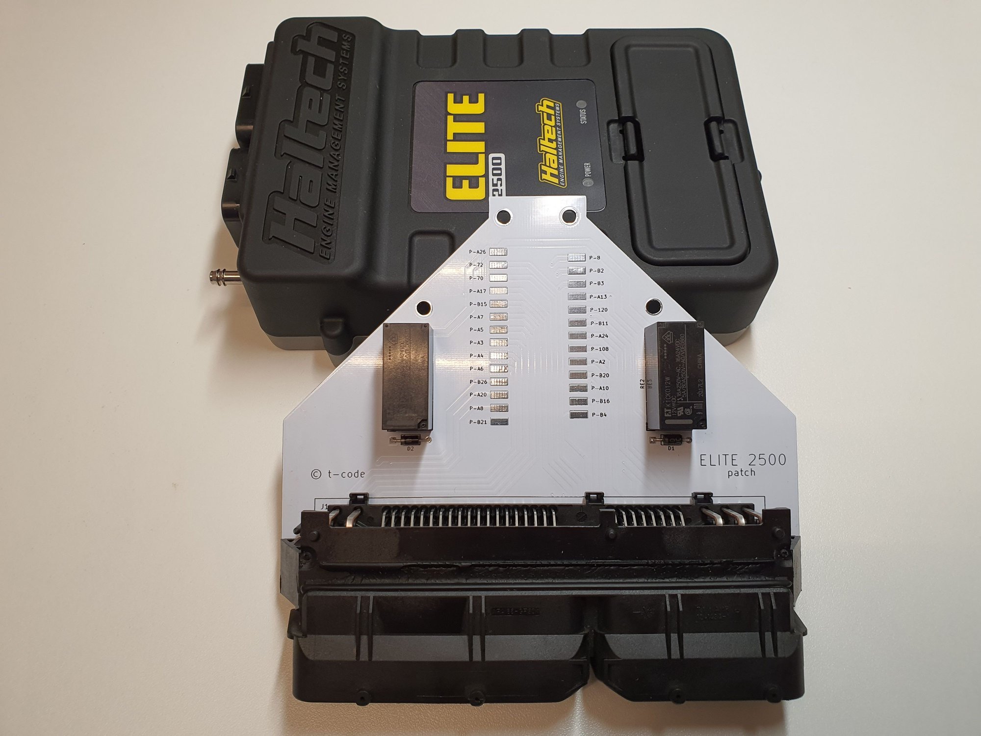

I'm doing a patch adapter/cable for the 350z to the Haltech Elite 2500. This is a prototype and it is working fine, I've successfully start the engine and it is running fine. No CEL, all sensors are working, DBW is working, CAN communication with the car is working etc.
There is just one issue, which I already addressed and fixing on the production version of the patch. The ECU is backfeed through A26 pin (injector power, used for power supply for the DBW throttle body) and won't turn off even with the ignition key completely removed from the car .
I'm adding a relay on that A26 line which is triggered by ignition +12V, it is tested, working. Now redesigning the PCB to fit 2x16A relays (working in parallel, so total theoretical max. current is 32A) which is pretty same value OEM DBW relay is declared for.

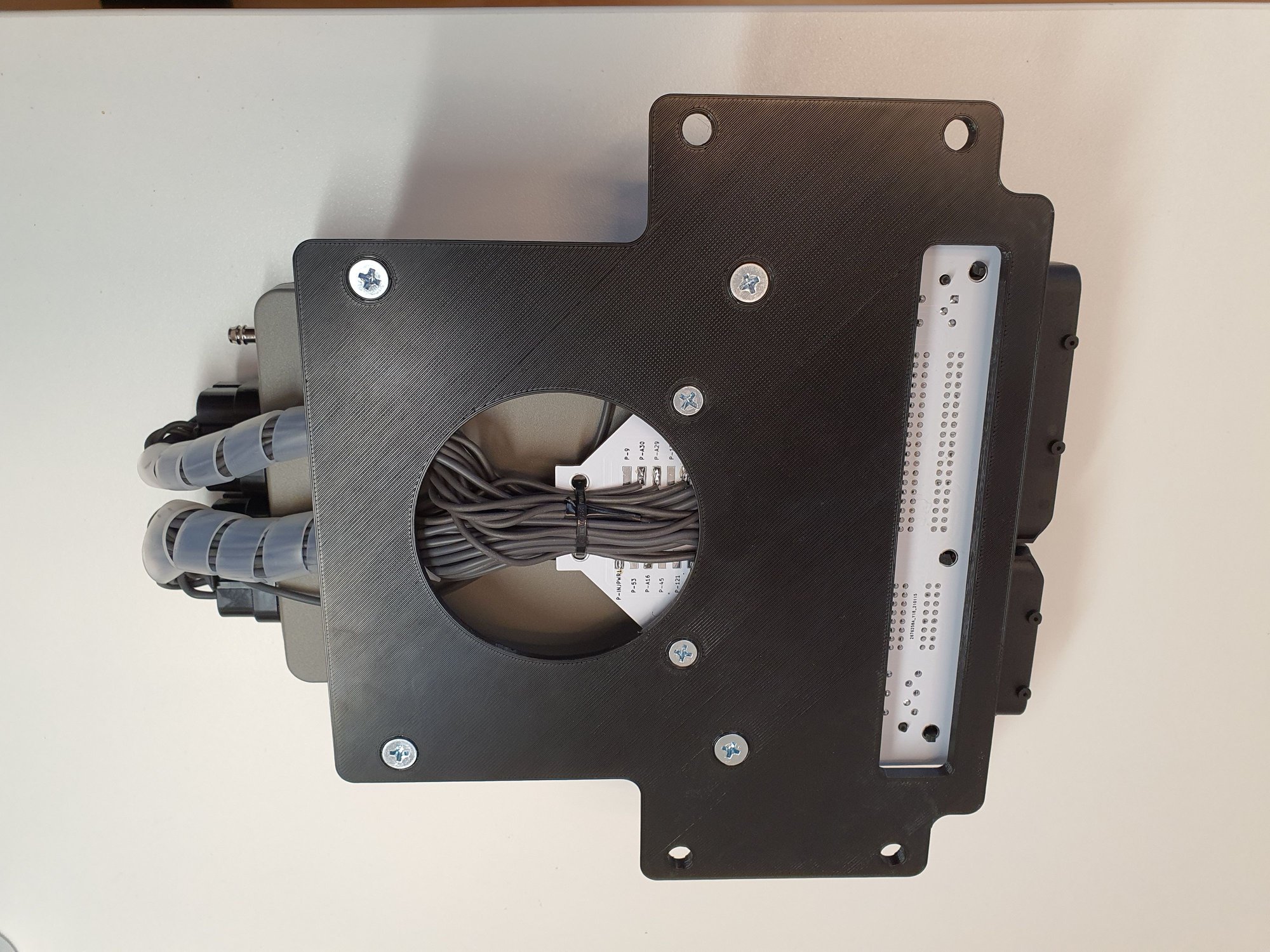

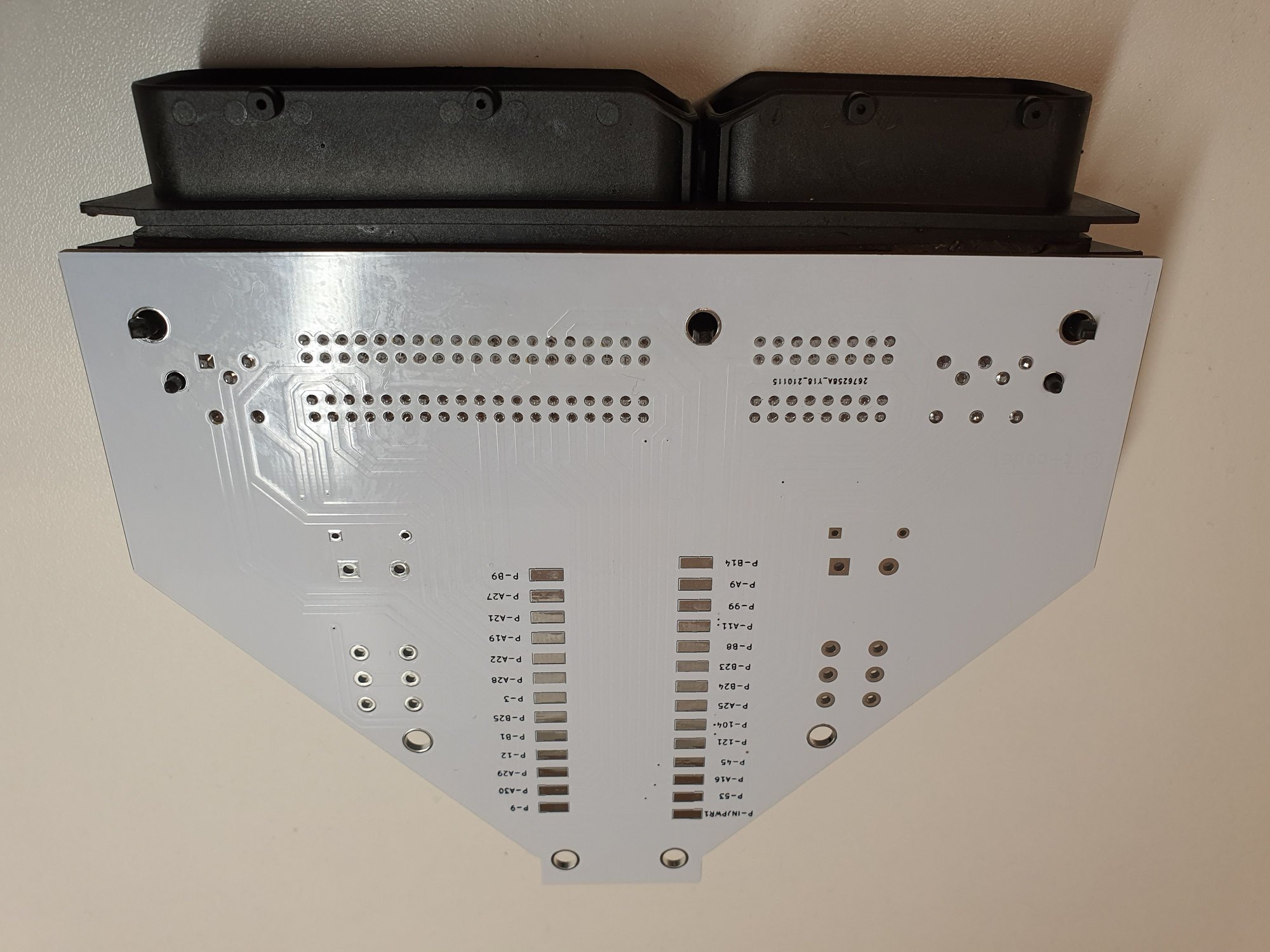

I didn't like other available solutions for the Elite 2500 to the VQ35DE, every I saw was incomplete so I made my own. I've designed a PCB, an adapter plate and everything is bolted and secured, using the smallest amount of space.
And finally fully assembled, reusing OEM ECU bracket for true PnP mounting:
Old Jan 22, 2021 | 07:03 AM
  #54
Conway_160's Avatar
Conway_160
Joined: Dec 2012
Posts: 2,593
Likes: 357
From: Pan Handle
You are F'ing killing it!
