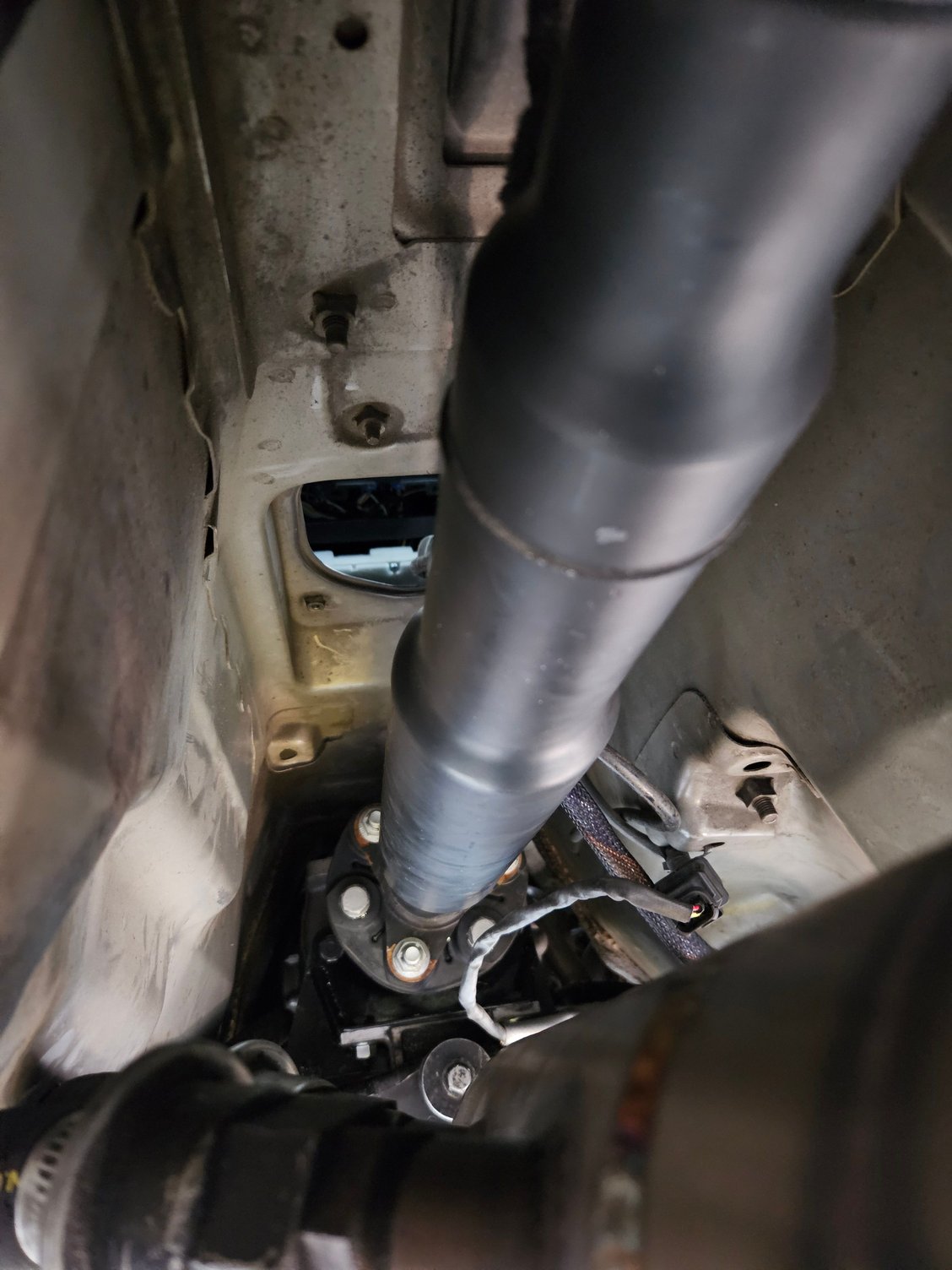

Unfortunately not, but I've done conversion to a ZF 8HP70 gearbox.
